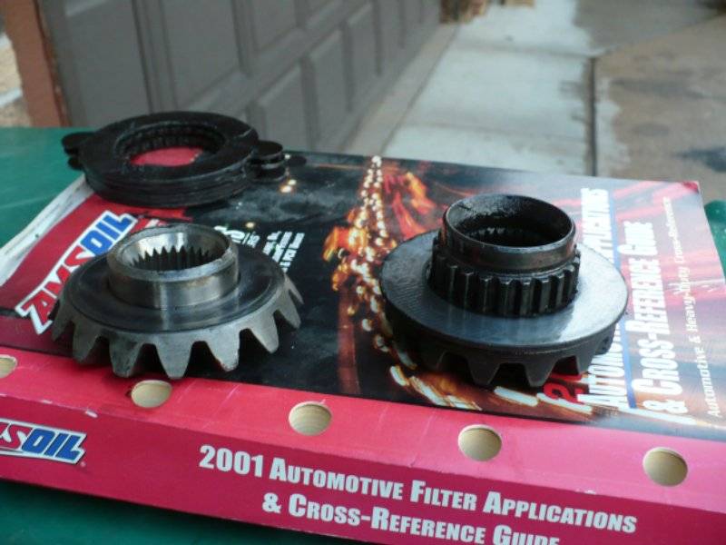

ok, I'm a bit confused,
I have a complete 02 explored center section. I want to pull the trak- Lok out of it, and pull my original 28 spline spider gears out of my open differential and put them in the explorer differential to make it a 28 spline in stead of a 31.
Will my original 28 spline open differential spidergears work in a limited slip setup?
Thanks guys
Mike
Posted by: slowmkviii
no sorry wont work

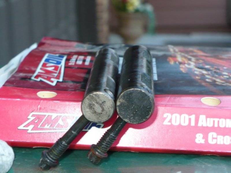

hope this helps on the right is a 03-04 cobra track-lok 31 spline side gear and pinion shaft on the left is a open diff 28 spline side gear and pinion shaft
