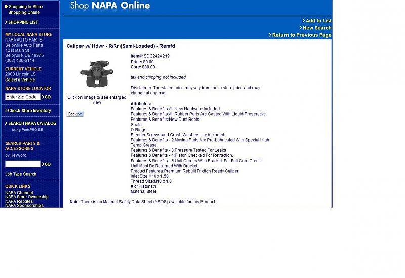

This sounds like a crap rebuild on the caliper, nothing more. Replace that caliper soon.
Also, I would recommend that you use your parking brake regularly. It keeps things moving that need to stay moving. Not using the parking brake can lead to failure from lack of use in this type of caliper system. If possible, try a different company for that caliper. I've bought two of the rears over the past 3 years and have yet to have a problem, but on my old Peugeot Mi16, I had terrible luck with the rear calipers from rebuilders, and it was the same style as the LS uses with the lever-actuated parking brake.

No, on the wheel bearing theory. You would have noises, to say the least, at all speeds.
As I stated, these calipers are prone to freezing up and lack of parking brake use actually accelerates that in the right conditions. (salt used on roads in the winter) The first one was just to be expected at high miles, then the replacement was not a quality item and that part of it was not as good as new as it should be on a rebuilt caliper. Find another brand. I used a motorcraft rebuilt caliper my first time, at around 100K miles and had no problems with it. All for around $80. My second car, after the one I put the motorcraft on got totalled, I got one at a local autoparts chain that has a dozen or so stores in the NH area, and have had excellent luck with it, also.
