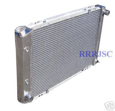

Any good radiators recommended?

I might have to take you up on that... how old are they? and any idea if this radiator will fit my mark ?
