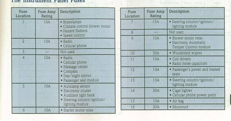

On my 97 lsc? I cant find a diagram for the life of me for the fuses on the left hand side of the dash. I downloaded the owners manual from the lincoln website but the page they were to be listed on is blank.
Any help?
Posted by: MERIJONS97LSC
:d
Posted by: sbcaprice305

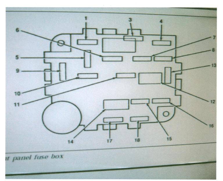

Thanks but on the 97's there fuse box is on the left side of the dash and looks nothing like that 1. On the side not under the left hand side......Any help?
Posted by: unity
Should be the same... maybe rotate the picture?
Quote:
That is from my 97 owners manual!

Ok, well after work yesterday i stopped by my p's to check out the lincoln. I was indeed correct about the placement. When you open the cover the fuses are stacked 8 high by 6 across.. LIKE THIS..
I dont get it, o' and there all mini fuses. Since i couldn't find out months back i pulled the fuses till i found out wich one was for my cig lighter. Found it and replaced it. Works! Easy fix. But i need to know what the other fuses are so i can hardwire my gps and radar detector. O' and a kill switch.

A helpful member over on markviii.org led me to this.........pg's 109-115 gave me the answer i needed. Thanks for the help though guys. Wonder why the lincoln website gave me the wrong info along with the guy that posted up his manual from his 97.
http://www.markviii.org/Downloads/Owners_Manual.pdf
