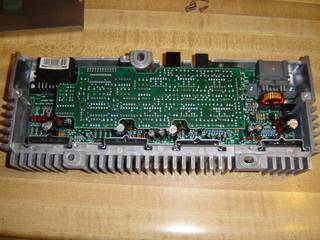

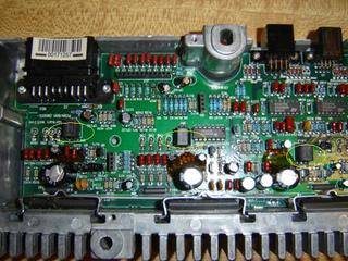

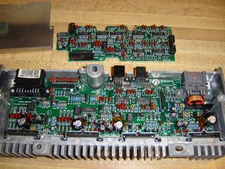

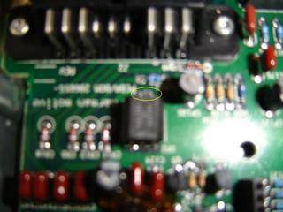

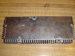

OK, I took a few pics, hopefully I can explain it.
Your amp is located underneath the rear deck in the trunk, you access it from underneath. once you have it out you will want to flip it upside down & remove the screws, it uses a small torx bit. after the cover is off you will see the main board with another smaller board attached to it. You need to remove this smaller board & set it aside. It should pull straight up, you may need to wiggle it a bit. You will now be able to see the 3 black thingys that are circled, they say vactech on them. you need to clip the wires on the LED side. It will say LED on one side of it. That is what you clip. Do it to all 3 of the black thingys. After that place the board that you removed back onto the main board & screw it back shut.
I did this to my friends Mark VIII & you could tell the difference. His volume was not suppressed after the half way point. If you try turning the bass up too high the speakers will get a bit distorted just like a normal stereo would. Over all he is happy with this little mod. It's not going to sound like a whole new stereo system, but it will give you added volume.
Please do this at your own risk! It worked for me, but you know how things can happen in life.

wow. thanks turborich. appreciate the time you took to help me. time to see what happens. oh , hey..... when i clip those wires.....just bend them out of the way or tape them???
Posted by: turborich
I just clipped them & gently moved them away a bit. At some point another member posted something about trying this, I don't know if he ever did it or not? So I figured that I would & it did help out!
Let us know how it goes. Good luck!

Just done it to mine. To be safe, i broke the metal legs off at both the Vartech LED and the solder ends. Only part that was slightly troublesome on my 93's amp was the fact that the top circuit board was held with crappy clips: (dog assisted me)
Attachment 34513 Attachment 34514

Got it done last nite. defenitely louder. dont know if i like it or not. by clipping all three, now the front speakers produce more bass also. now if you turn it up the front speakers rattle(no distortion) as well as the rears. now i have to take care of that. if i wouldve known the front speakers would also be affected by this i might not have done it. but it is louder and that is what i was asking for.
anyone know if only one of those controls the rear? if so i might solder the others back up so it just does it to the rear speakers.
Well you could always try soldering one at a time. I don't know which one controlls just the front? sorry.
