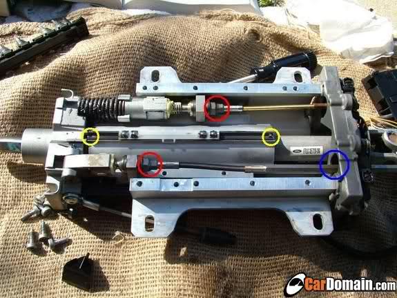

Well i lowered my steering colum to manually adjust the telscopic part of my steering wheel cause it was stuck all the way inwards. I removed all the torx bits to access the controls. I began to adjust the bolt and the steering wheels began to come out as it should have. I tried to mount it back up to the 4 bolts that hold it to the car and they were about 1.5" behind the mounting holes for the tele/up/down.. I put it back to were it was and it was still the same distance away from the mounting bolts.
What the hell did i do? Did i do something wrong? Or am i just forgetting something?

can you post a Pic?
Posted by: sbcaprice305
its the top red circle that you turn to extend the wheel manually. you'll see the 4 mounting holes that you use to mount it to the car. They are 1.5" further back now.
Ends up the steering shaft got pushed into the engine compartment alittle. Now my interiour is in 1 peice since last november.(blend door) It feels nice.
