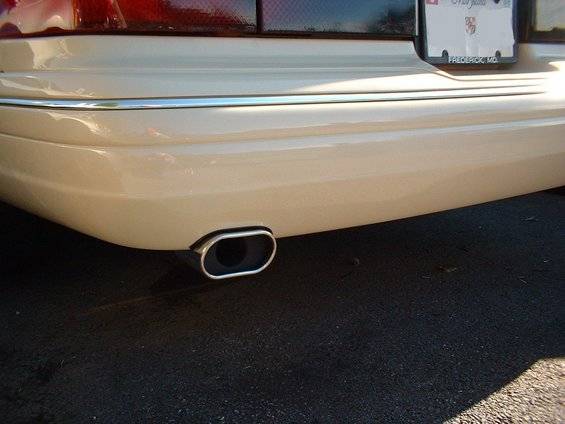

On my Marquis I notched into the bumper some and went with magnaflow oblongs:
Posted by: ground_zero298
Nice job on that tip install dRock.

Posted by: dRock95MarkVIII
Thanks. I'm no professional, but sure, I'd be up for a Frederick meet.

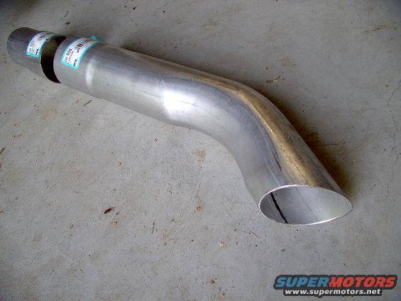

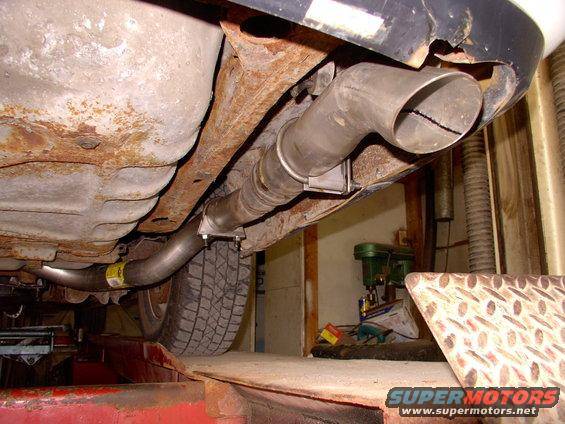

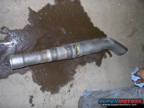

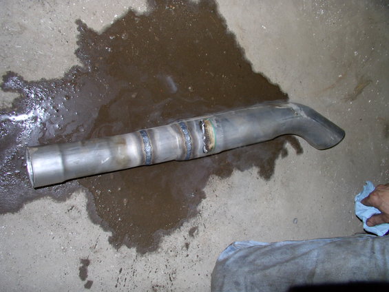

I welded this turn down onto my Dynomax mandrel bent Impala SS tailpipe
Took me from the real I.D. 2 1/2" out to the 3" at the tip
Looked like this;
Sixlitre
