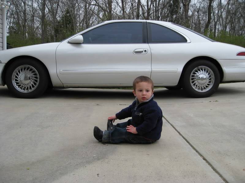

Car has been sittin since Friday night. The front seems a lil lower then normal though., but part of me thinks I am bein paranoid lol. What do you think?

The front end looks fine but the kid looks a little pist at your wheels being on wrong!

It looks a little low to me, mine looks like that when the temperature drops overnight, I recently removed the solenoids for some front end work and I'm thinking that I might buy the new solenoid seals from eddie and see if that fixes the problem, before that, I never had any problems.

They seemed just a lil lower then normal. The kid is pissed cause the other day it was 80 and he was in shorts and now it is in the 40's and he needed a sweater lol

To me, its just right.

well i'm no expert at pictures, but i'll bet you a strut the passenger side one is leaking. just take a tape measure and check from ground to wheel well on both sides, its very obvious in the pic the pass side is a good 3/4 of an inch lower then the driver side. you got a leaky strut dude!!
