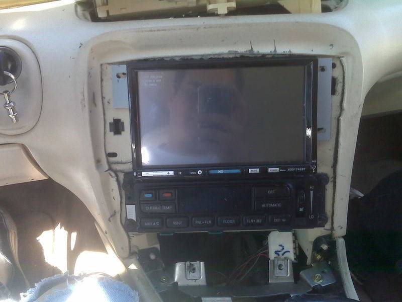

Here are the pics of my install, Hope they are helpful to someone out there.

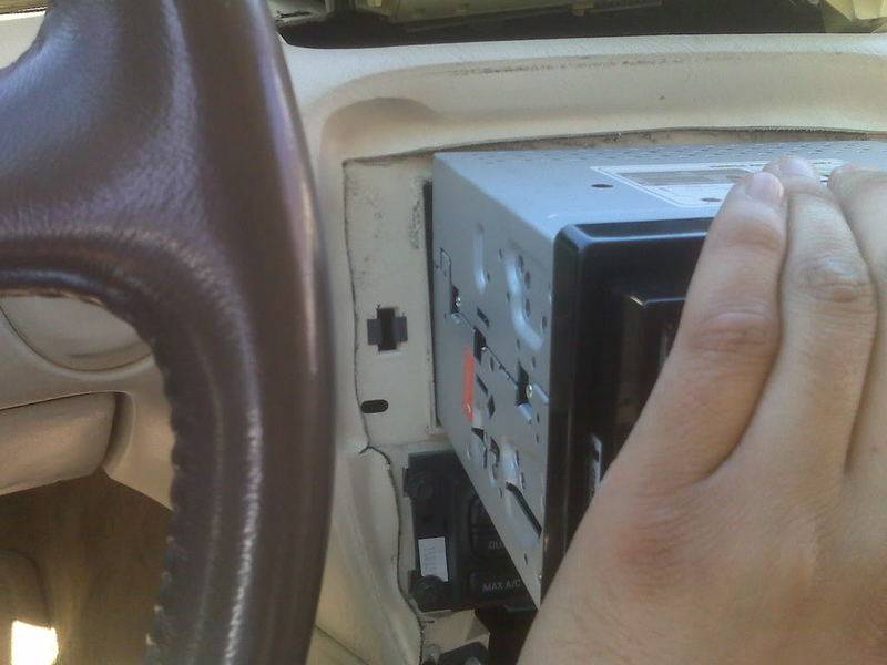

As you can see this was not a direct fit.

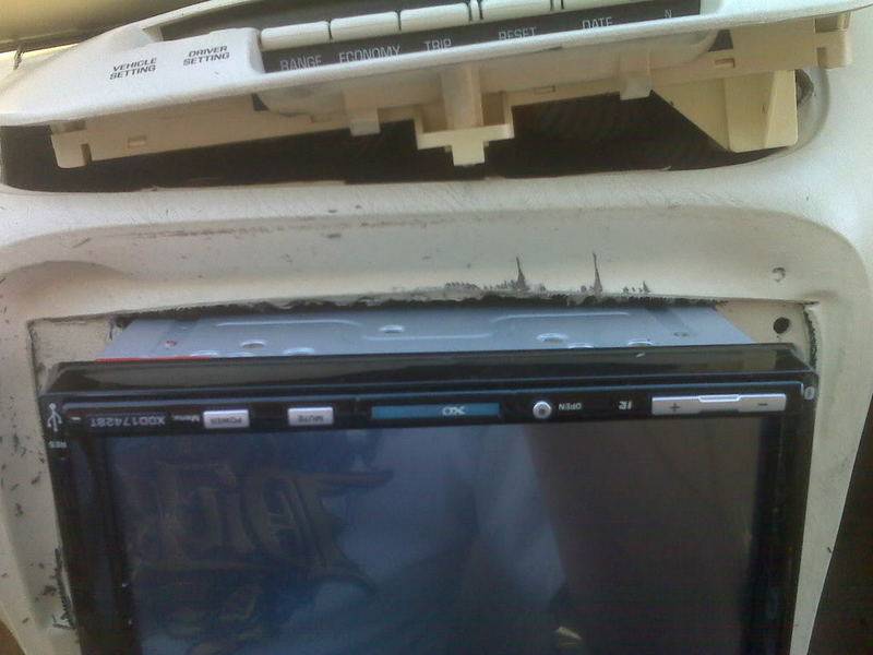

Some Modification was in order and I know everyone has their opinion on how they would have done it but this is how I did it and it worked for me!

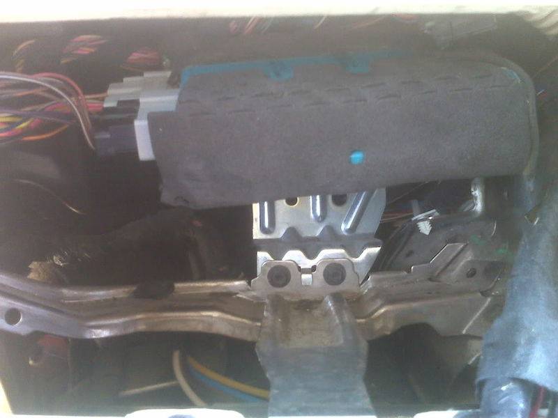

I also had to remove that bracket that holds this blue module and place it else where, due to this being a true double din.

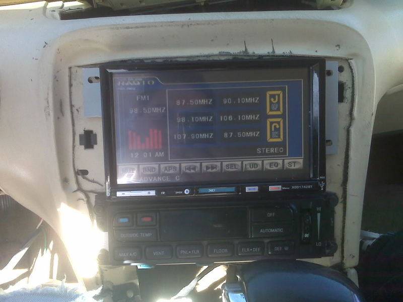

test fit

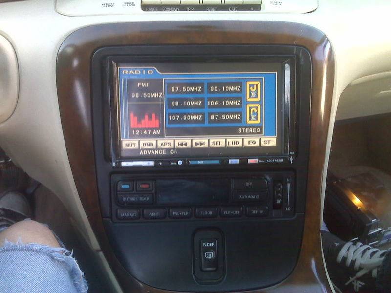

and bingo,
I Got a wire harnes and I am using the factory amp and componets, i also installed 2 10's in the trunk and electronic crossover, and a 400w amp. Everything sounds great and I'm very impressed with the BlueTooth feature of this d's and anything else you can think of. will post pics of trunk later.

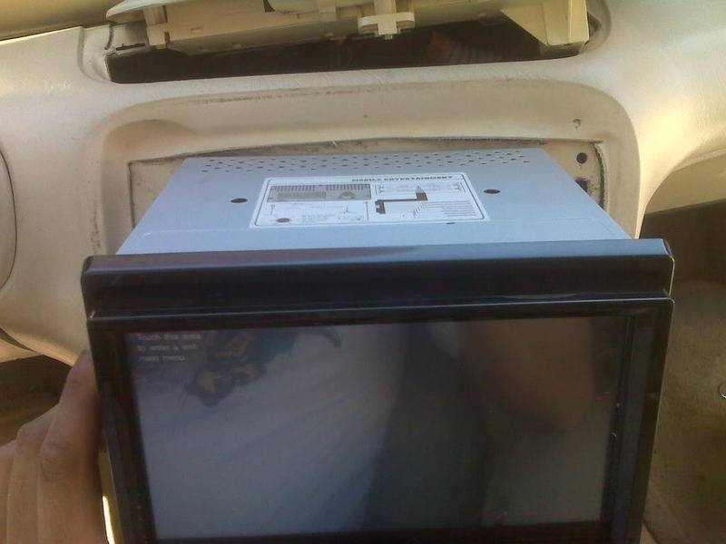

It looks like the bottom is extended outside of the bottom. Is the unit bigger than a typica double din? In my Avic D1 install, I trimmed away at the bottom, and took out the metal bar that acted as a rail for the factory radio. After I put the trim bezel back on mine, I have a cleaner fit.

The Unit itself is a Double din, But the LCD it self does extend to the bottom more than yours due to the fact that this one is a 7" LCD, the Avic D1 is only a 6.1" Screen. I did shave a bit of the top, there was no need to shave the bezel I had the screen slid down when in stalled the trim. over all it looks good ill post some more pic's you you can see how the large the lcd is. Had I shaving the bottom would have done me no good since the screen slides down.
