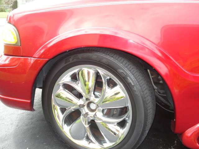

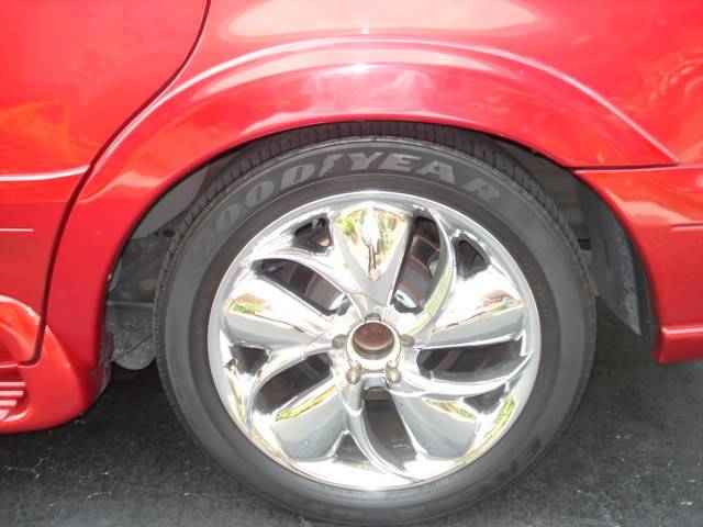

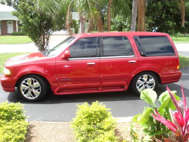

This is how my navigator looks driving or parked at all times. I have no check sus light. Every once in awhile I heard a loud buzzing from under near the passenger side front fender, I assume that is the relay. I don't know if my pumps are bad or just the relay needs to be changed and also the front is as low as the back and mine is not a 4x4 so the front suspension should not be air ride. Those are 20inch rims. If anybody can help me out that would be great. I'm not sure what the issue or issues are with this suspension. Also what would be a alternative to the air suspension. I have a set of 24s that I would like to put on the car but I can't with my suspension problems. Thanks

You can buy a coil-spring conversion kit from a vendor like American Air Suspension. This would replace the inflatable air springs with traditional metal coils. I think it'll cost about $800 for the parts...
Are you sure that the load buzz isn't the air compressor kicking on?
Have you gotten out of the car to listen for escaping air?
I don't know much about the Navigator system, but I have had a Mark VIII for years, so I'm hoping that experience will aid me with the Navigator ownership.
Posted by: lunchmeat
Maybe you pump has gone bad and isnt powerful enough to pump up the bags???
