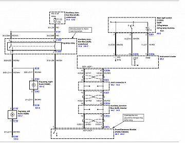

The fog lamp fuse is #03 and the relay is #07
(both in the underhood fusebox)
