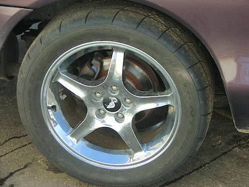

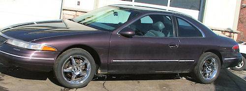

I took my prize to my local car guy and he was able to put the wheels and tires on without any difficulty.
The spindle grinding was done to the front by the gentleman that sold the wheels and tires to me. He had them on his 96 T-Bird oval track racer.
The Cobra R's are 17"x9" with the 4.25 bolt pattern. I still don't know what the offset is.

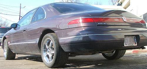

Front tires are Nitto 555R2 275/40x17 Drag Radials. The rear tires are Nitto 555R 315/35x17 Drag Radials. Tires have about 1/2 their original tread.

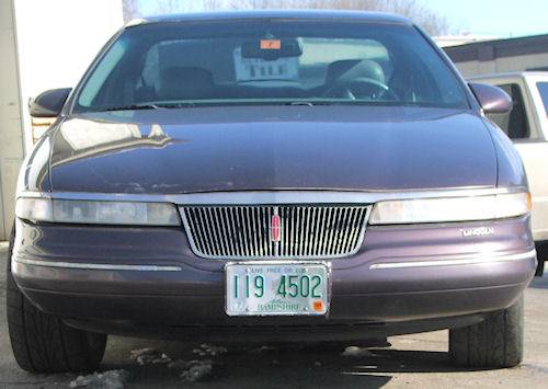

No rubbing anywhere. The wheel wells look high due to the angle of the driveway but even level they have plenty of room.
Took them out on the maiden voyage today and they stick like go-kart tires even in the rain.
Cost $750.00 for wheels and tires, $0.00 for spindle grinding, about $60.00 for some R&R on the rims that fixed a slow leak and $20.00 to put them on the car and hand torque them. Smile on my face as I lit them up for the first time.... priceless
