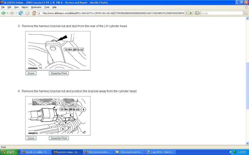

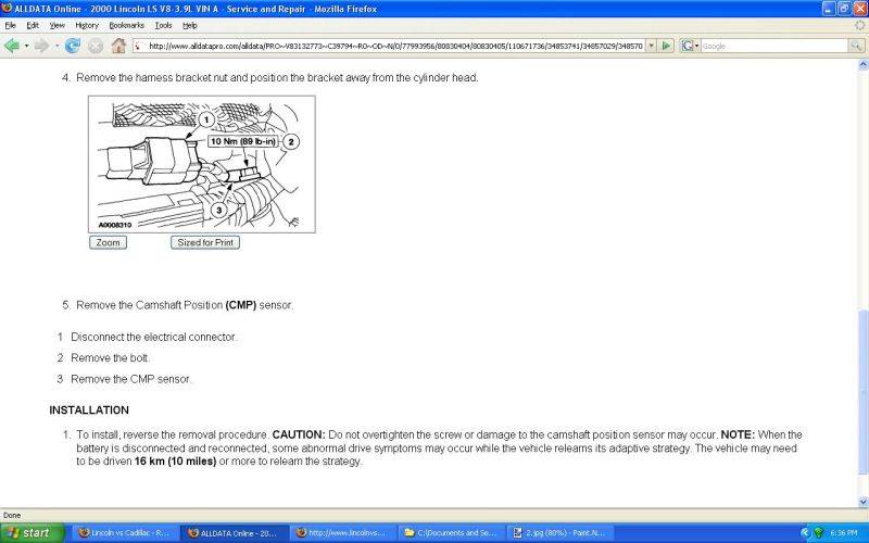

Posted by: ILLS
Here you go. This should help anyone that needs instructions installing a new CMP in their LS.
