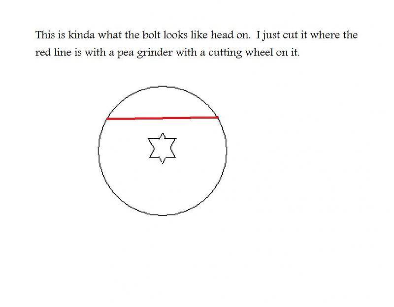

You don't HAVE to cut the bolt. You can remove the diff with the axles in place and the spindles hanging. You should be able to tell exactly which bolt I'm talking about once you're under it, but I'll try and explain it a little better....
The bolt head uses a TORX bit, therefore it is recessed where the torx bit engages the bolt head. The bolt head is actually about 2 inches wide. I just cut a horizontal line across the bolt head with a pea grinder. Again, you'll see why you need to do this to get the bolt out once you're under it.
If you can find a new bolt (maybe advance or autozone would carry it?), you could just cut the head of it off with a hacksaw or something and put the new one in from the other side of the hole. I would run out to the garage and snap a picture, but the car is at the body shop right now.
I drew this picture up in paint. It's late and I'm tired, so please forgive the crappiness.
If you would rather just remove the axle nut and go that way, by all means, go ahead, I'm just offering you the procedure that I did. You don't have to do it my way. Just go with what you feel comfortable with.
Good luck!
Posted by: ONEBADMK8
You can get those bolts back on without cutting, takes some time.
Posted by: Moes8
Quote:
+1,i never had to do any of that,it will come out with some effort,like getting the oil filter out by moving everything exactly right
