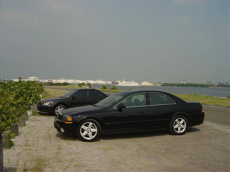

I attached a photo of the car.
I know a lot of these items have been covered before... probably all of them. I just wanted to introduce myself and my car.

Good lookin Gen I!!!
