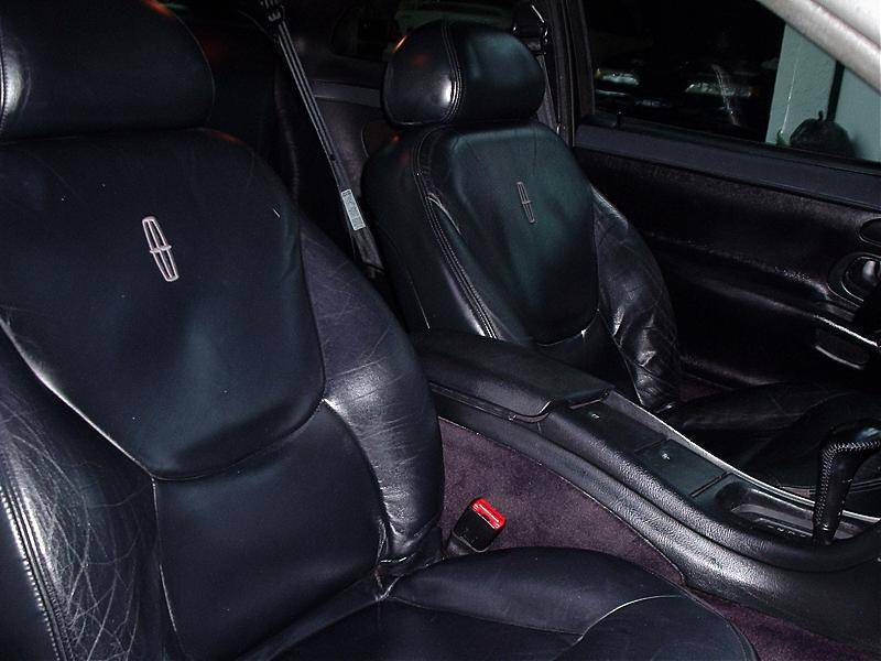

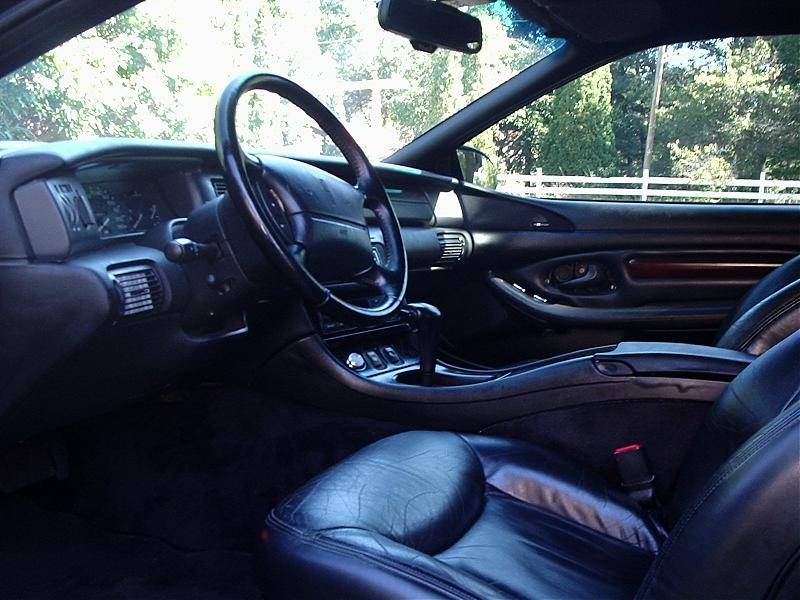

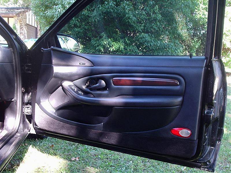

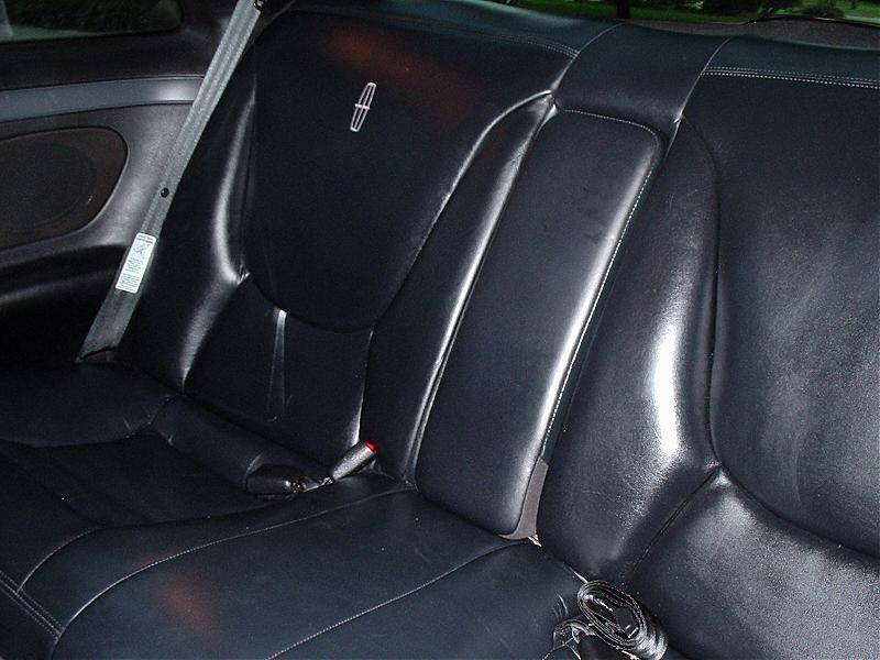

I dont have any step by step pic's but here are mine after they are installed.
