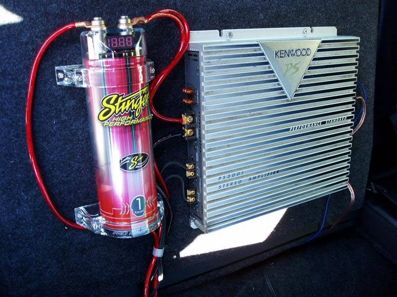

My boomin' system:
Nothing crazy. Kenwood amp, Kicker 8" sub and Stinger cap. Just enough bass for what I wanted. I had all this stuff sitting around anyways.

What head unit are you running this off? That looks like exactly what I want, I am long done with the huge subs that shake the $hit out of your car. I like your setup a lot.

Thanks. I'm the same way - done with the bass that you can hear for blocks. And honestly, a lot of people that have heard it said they couldn't believe it was only an 8" sub. But to answer your question, it's run off the stock head unit using a line out converter tapped off the stock rear deck subs.

I am begining to think that I have these speakers, just have not noticed. WHICH makes me want to throw something together much like what you have. What cap is that? Can you give me more details of what you have. Watts? Thanks in advance.
Posted by: NYC LS8
It's a Stinger 1 farad cap, older Kenwood 300 watt amp and a Kicker CVR 8" sub in a ported box that I got off eBay.
One more picture that I found..
Hope that helps.

Did you wire it into the existing battery or add a deep cycle?
Posted by: NYC LS8
Stock battery. I tapped the remote wire for the amp into a diode in the trunk fuse box that's for the fuel pump, so the amp only runs when the key is either in the "on" position or the car is running....so it's all wired up in the trunk with no need to run wires all over the place.

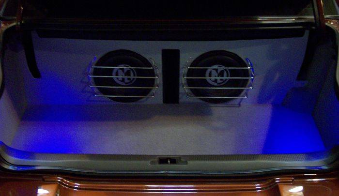

Factory Alpine 6 disc-changer with two Memphis 10's and a Memphis amp. Running 400 watts. USAC rated at 128db. The material used to trim the trunk is an exact color match to the interior. I did the trunk myself. The amp is hidden.

Rollin I've said it before and I'll say it again,
Damn that car is beautiful.
Posted by: svince1884
Dude, that setup is awesome.....you did that yourself huh? You offering any tutorials on how to do it?

Sure. I have already explained it to another member here. I can tell you how and even post up pictures. What to you want to do?
