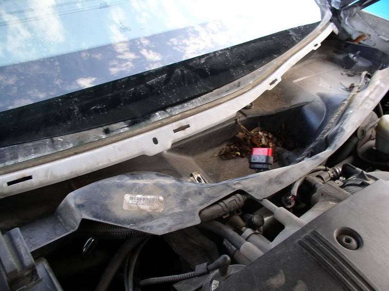

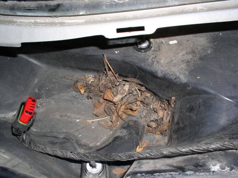

I did recently have to fix a vacum line on the intake.
And had my cowel drain pan filling up and overflowing into my heater vent.

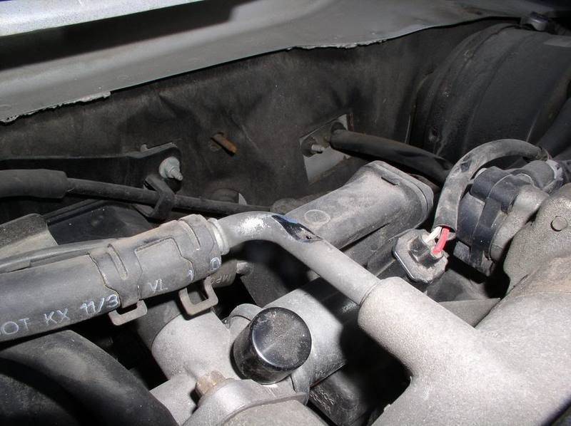

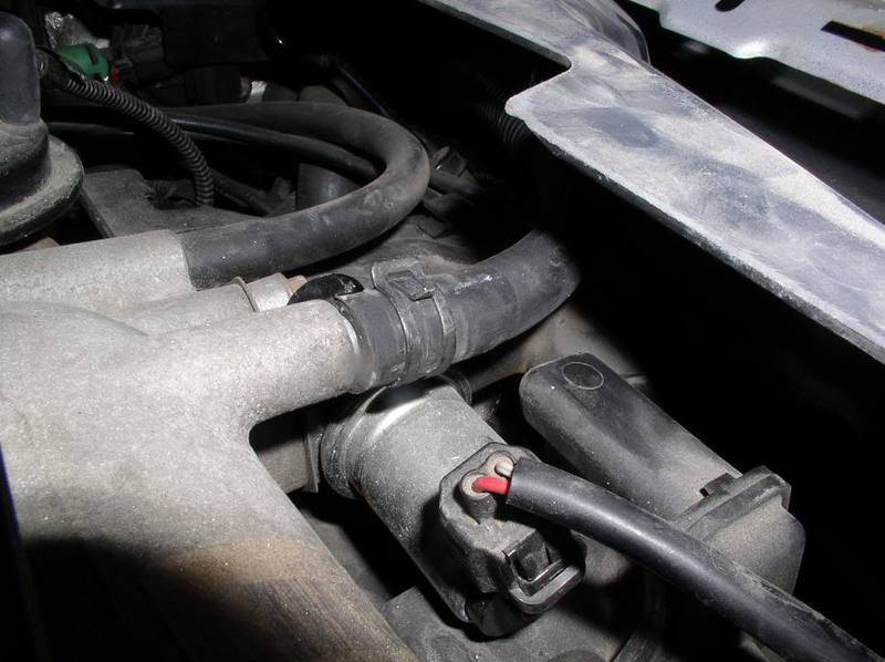

I took the Idle Control Valve off and it still looked clean. I just replaced it last year. I also checked the vacum lines, they all seem to be tight and there is no hissing sounds that I can hear where there would be a leak. I do have quite a bit of ticking noise coming from around the fuel injector area.

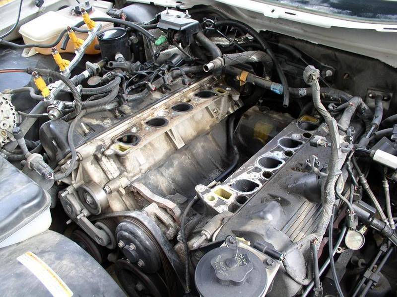

I'm pretty sure its an intake manifold leak.
Posted by: 99 Towncar

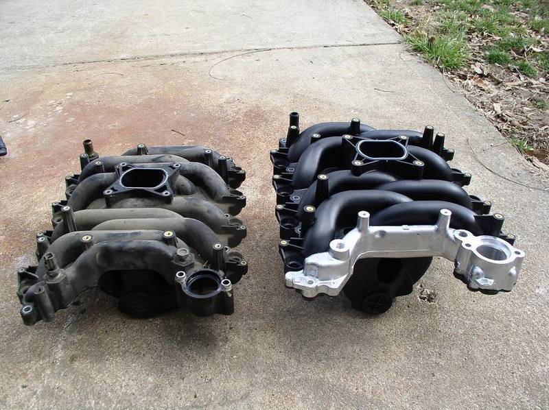

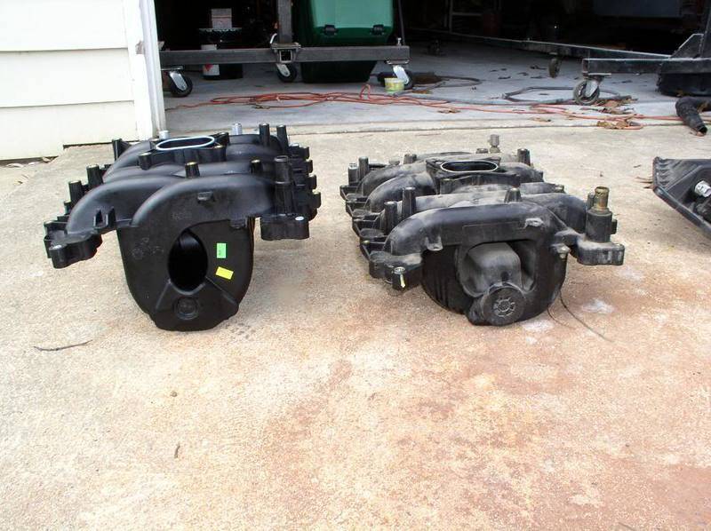

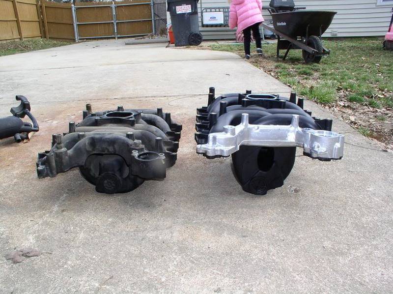

Well it was an intake manifold leak. I went ahead and updated the intake manifold while I was at it. And I figured while I was doing that I might as well go ahead and do the PI intake swap for more horsepower.
Posted by: slowmkviii
The new one looks nice
