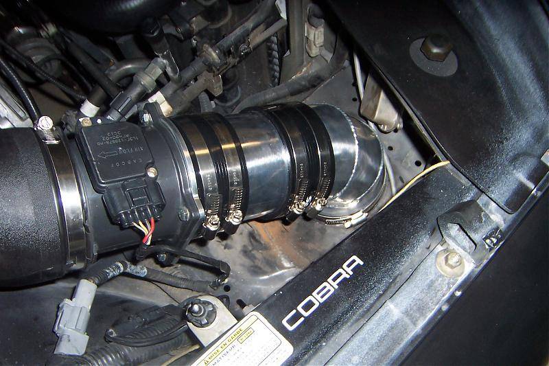

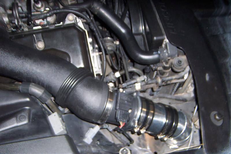

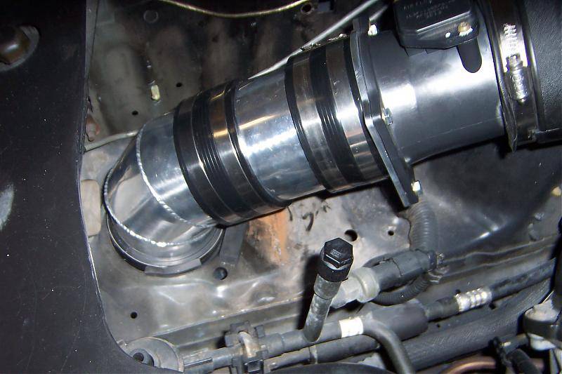

After the 42lb nightmare I decided to keep the mass air sensor and do a custom cold air intake. Tell me what ya think!
Posted by: Markviiiedrea
I like that allot better then the LMS one, did you weld that up your self or find something at home depot? Notice any difference in sound or performance?
Posted by: lscmkviii
I got all the fittings from ebay 4" aluminum intake parts. It sounds very nice and it brings in cold air! So its functional!
Posted by: unity
Where is the filter?
Posted by: mikemark8
yea, where IS the filter??
Posted by: NYC LS8
Gotta be near the air ride compressor.
Posted by: devilchild
i would hope so.. or it wont be functional for long..
does look pretty cool though
The compressor is gone. I have a 4" K&N cone filter in there.
now that we know that the compressor is gone... good idea jamming the filter in there..
i should have thought of that on my last mark viii
Posted by: turborich
That is a very clean set up, I like it a lot! It is also a true cold air intake. Nice job.
Posted by: driller
You can leave the compressor in there, you just need to lower it about 2".
Posted by: 98LSC32V
Your mass air transfer function is definitely off with the bigger MAF and the bend in the intake. Besides that it's a cool setup.
