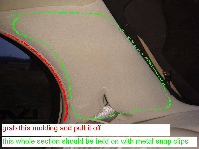

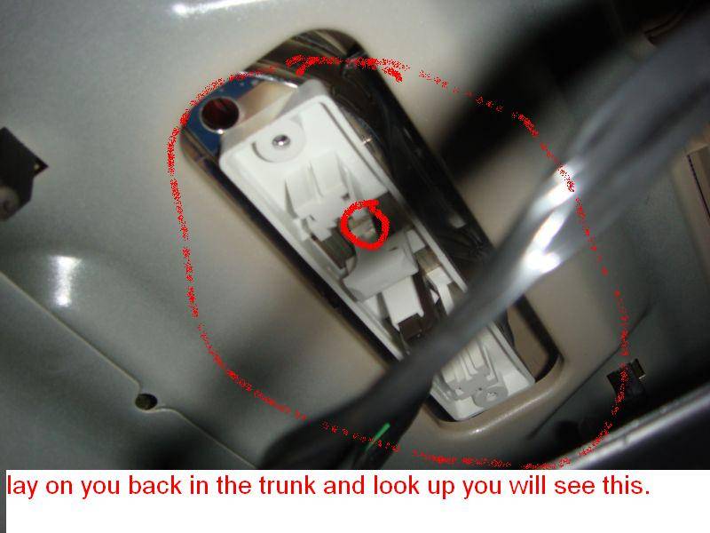

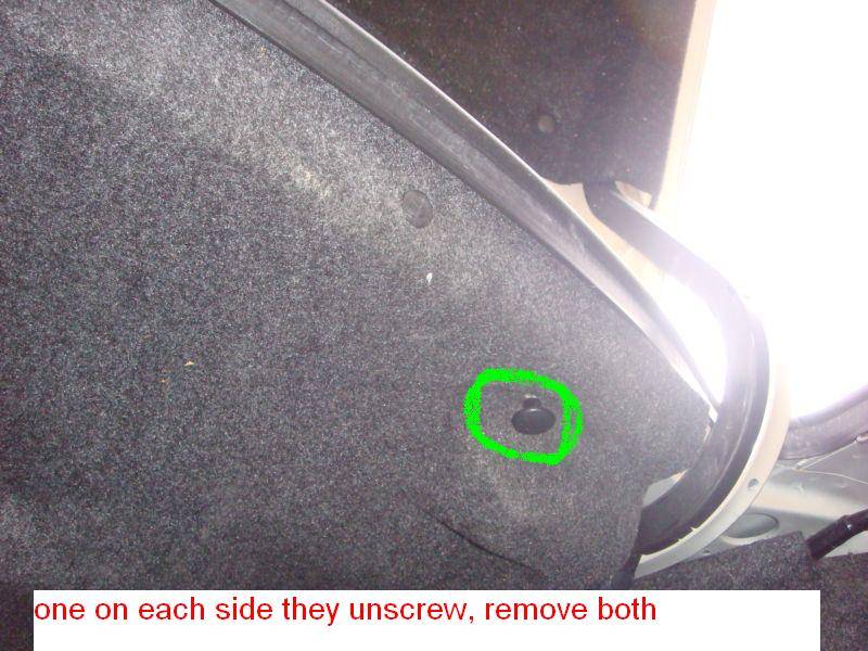

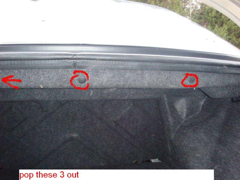

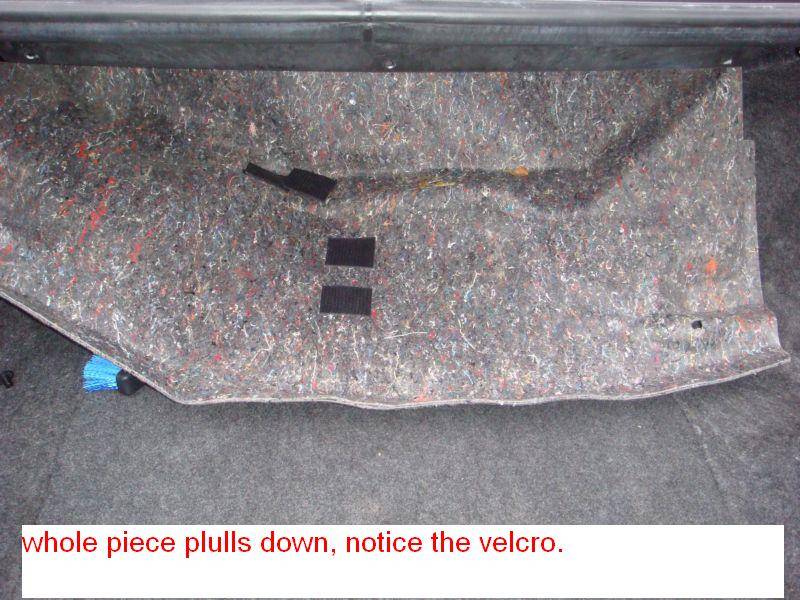

Good Afternoon Everyone, I have a 99 Lincoln Continental. Is there anyway to replace the top stop light that is above the trunk in he window? Second Question, What part off the paneling do I need to remove to in twist my back seat belt for it to work?
Thanks for any help that you all can give me. Thanks for havinf such a great site
Posted by: ground_zero298
here's the info I put together for ya for the brake light.
if it's the center seat belt, your on your own.
Posted by: dubville
Thanks alot for all your help. It's the side one. I appreciate it very much.
