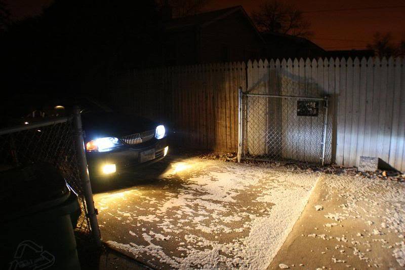

Posted by: stuntin_LS
since he's slow heres my ebay HID kit... cept mine ran me 150 dollas they run at 35w and are 8000k, love em!

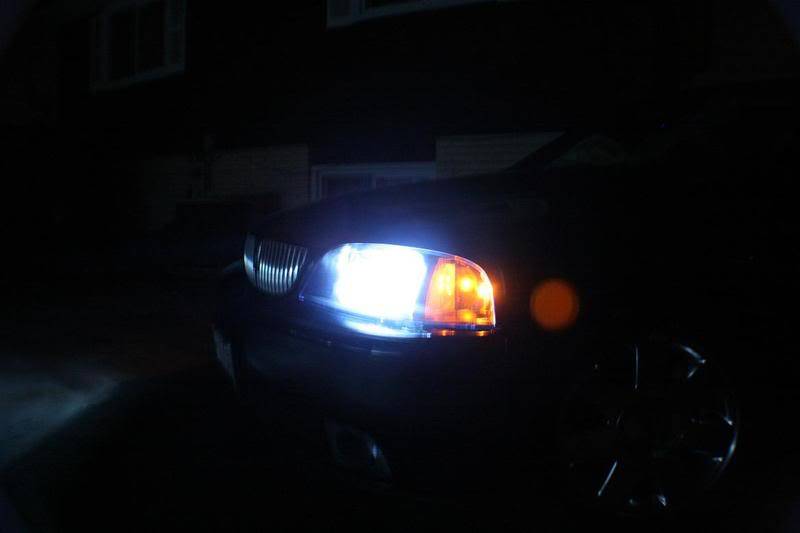

Posted by: hellvez
here is a quick pic to show the color of 6000k
