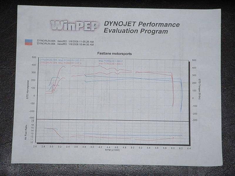

2.5 Hour DYNO TUNE = 337.9 HP & 405.4 TORQUE
Posted by: Brock
The chart can be seen clearer if you click on the forum below.
http://brocktownsend.forum5.com/view...=brocktownsend
http://www.fastlanemotorsports.us/UHome.asp
(Factory tune run produced 229.2 HP and 245.3 TORQUE. The "Blue Line" run of 251.3 HP and 286.2 TORQUE was a "HARD SHIFT PERFORMANCE TUNE." The "RED LINE" run of 337.9 HP and 405.4 TORQUE was with a 100 shot of dry nitrous. The graph shows spark misses which the tuner told me was caused by the plug gap. I gapped them down from 44 to 37, but he said they should be gapped between 32 and 34. BT)

That is some pretty nice torque numbers. Closing that gap will help if you are having a little blowout occurring. You will probably lose a little bit of power in the area's of the curve that the spark is not blowing out but you will be better off overall.
Posted by: Brock
Yes, the HP was what I was expecting, but the TORQUE was quite surprising. I was also happy with the air/fuel ratio. I know it is a tossup, but I was wondering what I should close them to, as I would rather do it only once. I guess 33 to be in the middle?

What impresses me the most is the "blue line" reading with the tune. 20hp and 40ft/lb's with an aftermarket tune is amazing. Can't wait to get an Xcal.

The tune that came with it produced 232.45 HP and 257.64 TORQUE. That DYNO shop then told me I should go to FastLane for their DYNO tune, since all he had was Sniper which didn't support the LS. He said that nothing could beat an actual DYNO tune, and at least in this instance, he was correct. The 2.5 hour DYNO tune cost $170 complete, but with the increase to 251.3 HP and 286.2 TORQUE, I feel that it was well worth it.
