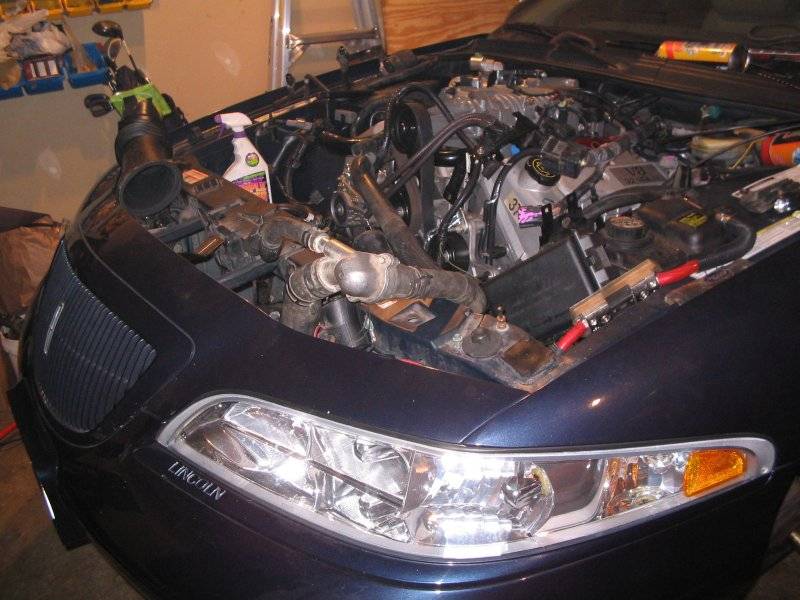

There is a guy that installed a supercharged engine from a 2003 Mustang Cobra into a 97 Mark VIII.
Posted by: stone17
here the car.

Thats exactly what I needed to know, Im going to go with the 2003 cobra motor. I will swap out the stock supercharger and pop in the Whipple supercharger, and throw in a bunch of other little goodies. Ill probably wind up with around 600 Hp and 580 lbs of torque, but who knows for sure until I get it on the dyno tester. Thanks everyone for your input, expect to see a 97 Mark VIII doing low 11 second quarter miles before the year is up.
