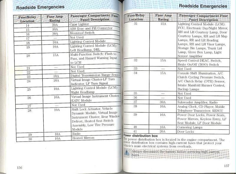

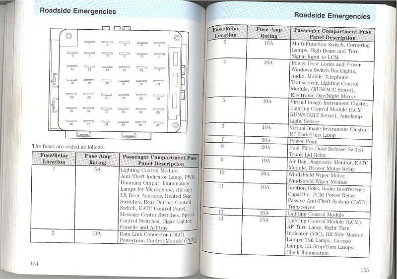

Friend of mine has a 00 Conti and he lost the fuse box cover somehow. Does anyone know where I can find or have a diagram of the fuse box fuse locations?
Thanks So Much
Dave
Posted by: hrmwrm
in the owners manual is a legend for the numbers.
