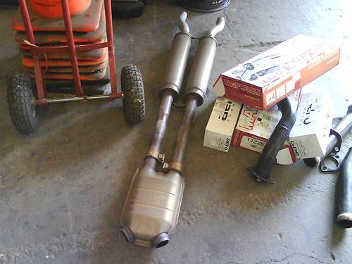

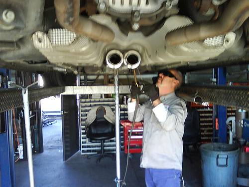

Third cat Bull S***
In reality as well, the stock system has some wicked bends that arerent needed. Look at the tail pipes in this.
Posted by: NateRW21
WOW... you feel really strong about that third cat huh?
I'm going to go the route of the obvious here, but you're positive that's a third cat and not just some sort of crappy cross-over chamber? I've not looked at the exhaust that much and my manual doesn't reference specific cats or quantity... and the emissions part of the manual only goes up to 02.
I was really looking for something where I knew what sound I'd be getting... the resonators and mufflers were my real interest, not the piping. Maybe I can get some 2" versions of the same resonators and mufflers that come in the kit; I'll have to look into it.

Yes it is a cat. Its a cat and a crossover built in one.

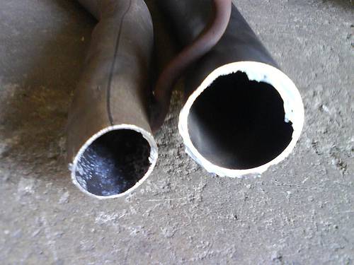

PLEASE do not get 2inch mufflers. Im telling you that crush bent piping will still be more free flowing then that stock crap.
Look at the stock diameter comparted to the new 2.5 in.
-- I am done wasting my time trying to explain this for you. MOST everyone who know what they are talking about are going to tell you the same thing I just did. If your not going to take our advise, go buy 2in mufflers and gain 2 HP.
Posted by: NateRW21
Crushed 2.5", at a 90 degree bend decreases the flow by about 20-25%; this is equal to just a hair over the flow over a 2" mandrel bend. So in reality, you aren't getting that much of a flow gain (you will only flow as much as the smallest point). Certainly not enough for me to bother with having pipes bent up and installed.
I'm looking for a suttle muscular sound and given Magnaflow said they couldn't do much to better the factory exhaust as far as performance goes... I have serious doubts what benefit new pipes would have for a pretty much stock gen II LS when you take the "third cat" into consideration (which I highly doubt I'd consider removing). I'd be happy with new mufflers and resonators to give me the sound I want.
As far as Mandrel vs pressure bending... The numbers don't lie; mandrel bending flows better with less turbulence. This is an indisputable fact; if you're happy with your pressure bend pipes, good for you... but that's not good enough for me. If I'm going to do something, it's going to be right and with all available technology... that means if I do pipes, they are mandrel bent and stainless (Galvanized would only last a couple years here in MI, even though carbon steel retains heat better, keeping velocity up).
