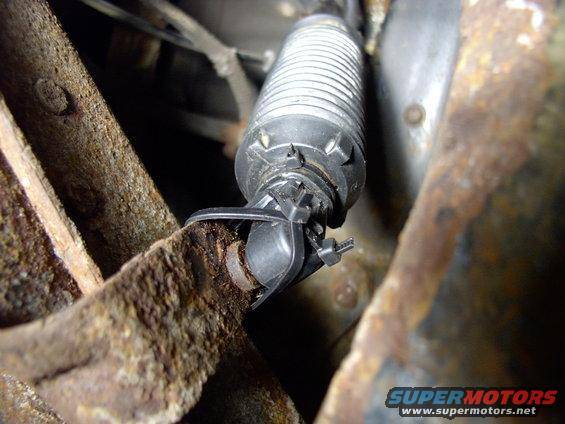

Could be your height sensor (looks like a tiny shock)
has lept off the ball stud on the axle or chasis bracket;
For a while I had mine tie wrapped like this;

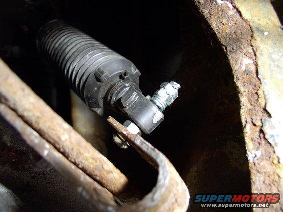

Now mine looks like this;
and she ain't jumped off since (grin).
Read up on the 25 cent mod here;
