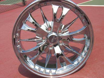

Bought these wheels on ebay and was wondering what size tires you 18" guys are running.
Some of the tire websites recommend 245/40/18.
Can I go wider than this say a 255 or 265, at least on the back?

Depends on the offset. I have the Jag Type R wheels with 285/35 tire on the rear.
what offset do you have and the width of wheel too?

Size
18x7.5 Inch
PCD/Bolt Patterns
5 x 108mm or 5x4.25
OFFSET/ET
+35mm

Play around on this offset calculator:
http://www.1010tires.com/WheelOffsetCalculator.asp
Stock wheel is 7.5 wide with a 60mm offset
Yours is 7.5 wide with a 35mm offset
You are coming out closer to the outer lip by about an inch.
I would be hesitant to go any wider than 245 with that offset.
Awesome looking wheel BTW!!

Probably no more than 245 with 7.5 wheel.

ok i'll go with 245's.
Always liked 5 spoke wheels.
These are double 5 spoke and pretty light weight.
Thanks guys.
