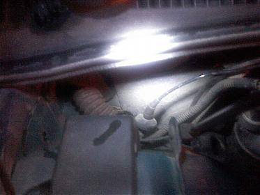

The fitting was right above the middle of the intake plenum and ran across the top of the fire wall to the passenger side corner of the firewall. ill try to get a pic or to for you.

Right underneath the light almost in the corner of the passenger side fire wall
Posted by: slickemhoundd
Thats the line that runs over the intake plenum
