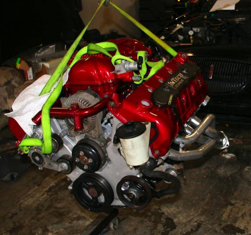

This is where I tied the engine to put it back in.
