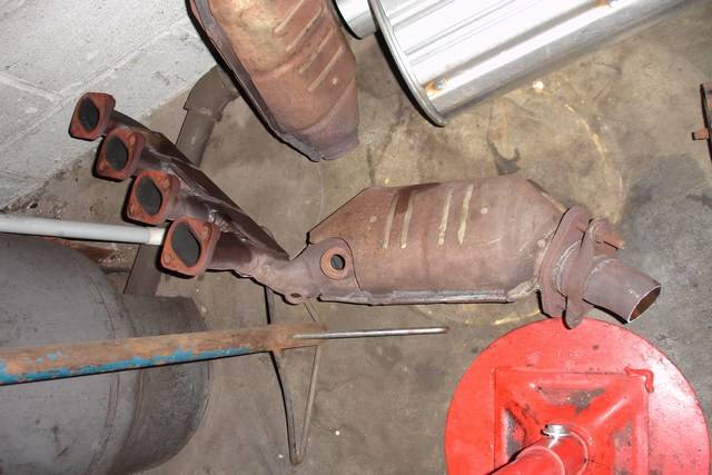

I've been tossing a lot of ideas around for my exhaust on my car. When I finally get the motor out i want to do something because it's far easier to pull the manifolds with the motor out.
I would love to go kooks, but i can't justify spending that much money on just headers. Other than kooks my list of options are as follows.
Ford Racing shorties
96-98 cobra
stock
After tossing around all the options I think I finally decided to stick with stock, with a few modifications. I was thinking that I would cut the cats off and weld straight tubing on to the manifolds. Deleting the cats should open up the flow a little bit and it will get me by until I can justify kooks. Has anyone else modified the stockers?

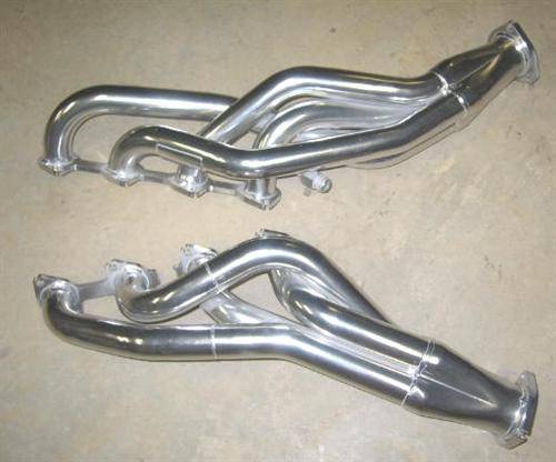

They are simply "Tee Logs" with virtually no concern for flow. The "shorties" can be used but I believe need modified as well as the modding the steering shaft joint. Long tubes require custom modification to fit. Long tubes, while best for flow, will not allow the tranny to be dropped without pulling the entire drivetrain.
Enter the 3/4 length Kooks...
Pretty much a bolt-on deal even though the steering shaft joint may or may not require modification. Considering the confines of the application, they flow well and allow access to drop the tranny if needed.
Justification of the price is a personal opinion, but if you're already pulling the motor and modifying the exhaust, I suggest you're not saving much for the tradeoffs considering the whole is the sum of the parts.

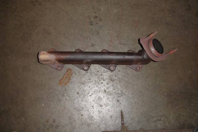

I just picked up some 01 Cobra manifolds locally for $25. The manifold dillema is done, now I just have to decide wether or not to delete egr.
Posted by: JoeyLincolnMK8
Delete the EGR, it is totally useless.
Posted by: unity
Quote:
I though the 01 manifolds were pretty much what we had? The 03+ have larger ports thus better flow. No?
Posted by: kustomizingkid
I'll post up pics when they are in my posesion (My grandpa picked them up because they were down the street from him). They aren't headers, but they are much better than the stock Mark units. They also have bolt on flanges for both sides.
