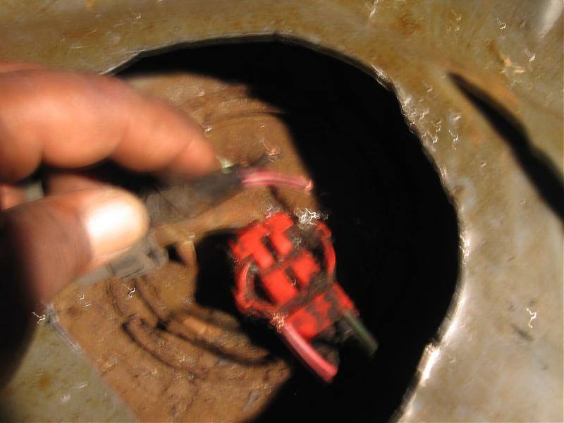

Anyone out there ever have any issues with their automatic fuel pump shutoff switch? I cant get my 90 Mark VII to start and when I check
the auto shutoff switch, the red button is pressed completely down.
The only way to get the button back up is to unhook the switch
and use a little flat bladed screwdriver to pop it back up. There is
also something loose inside that rattles when I shake it. It this normal?
I have never messed with this switch before and would like some
feedback before I replace it. This is the switch that is located in the trunk
on the left hand side behind the metal panel right next to the air suspension switch. Thanks folks!

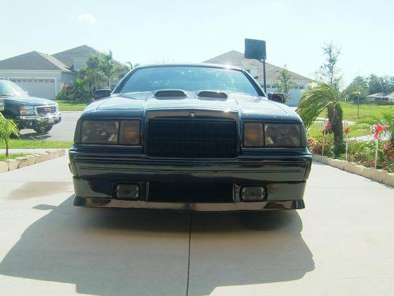

Thanks for the idea. I am off tomorrow and will give it a shot. Will post the
results on here. Here is a shot of the front end. Hope to have folks on the road looking at the rear by the weekend!

Your inertia switch is a normally closed switch. The button is normally down.
If you disconnect the switch and then jumper the two wires together and the car runs fine, then the switch is bad and MUST be replaced. The reason for the switch is to shut off the fuel pump in case of an accident.
These switches normally do not go bad unless used excessively.
