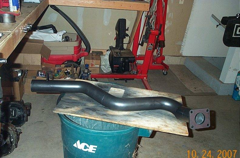

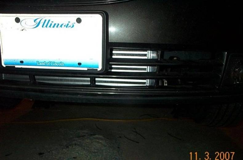

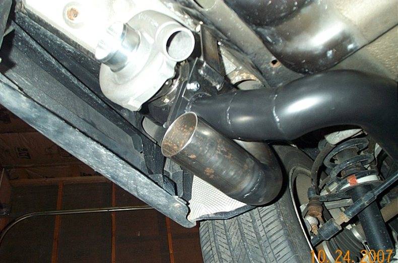

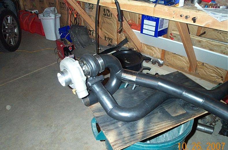

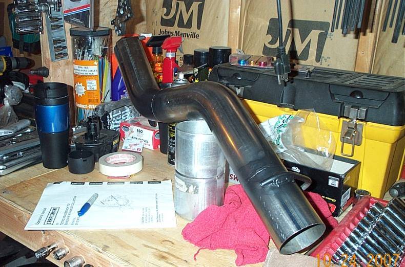

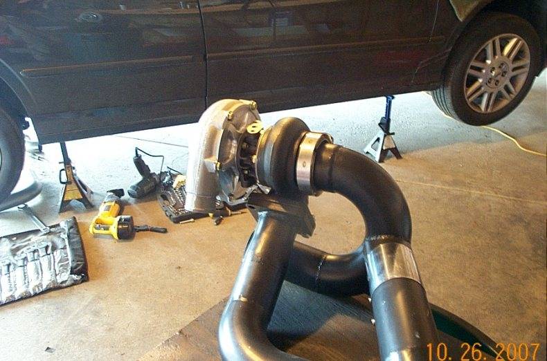

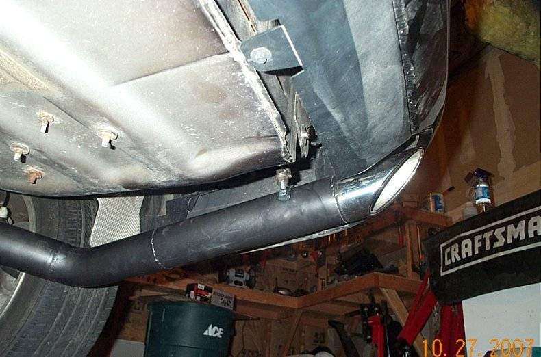

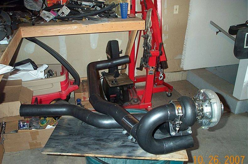

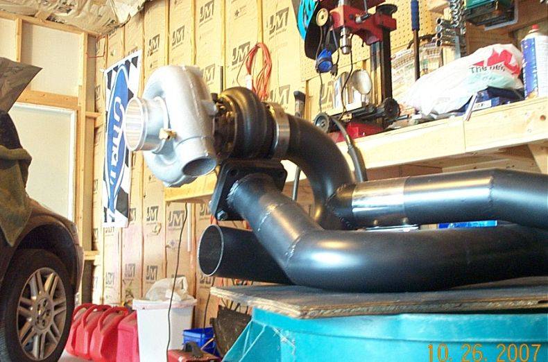

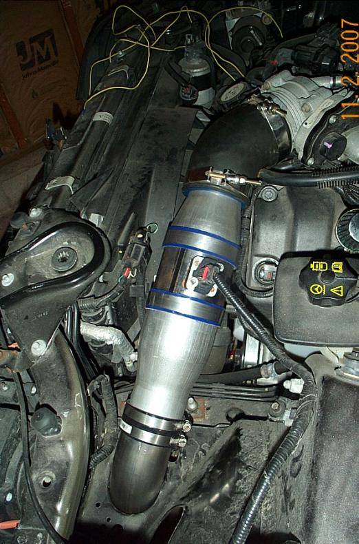

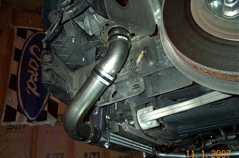

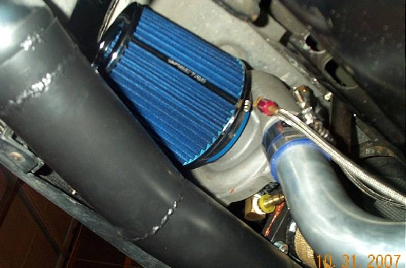

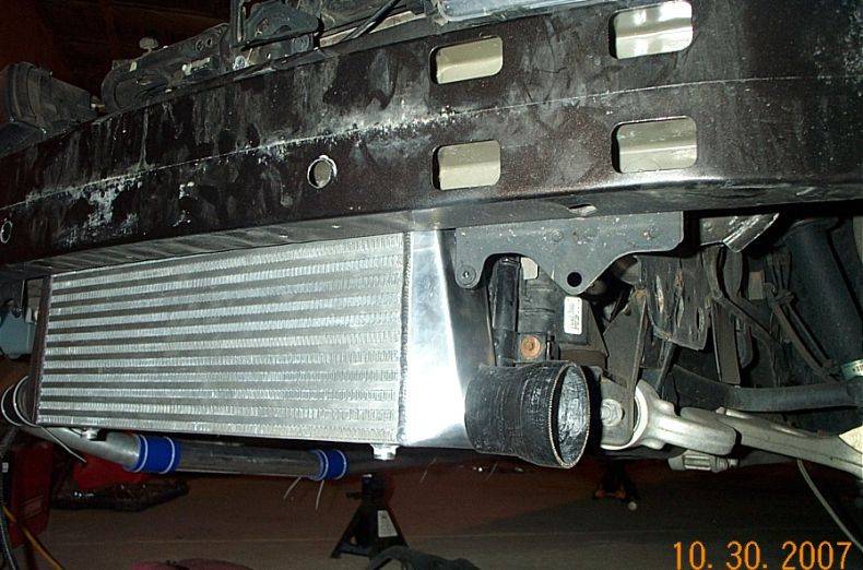

Posted by: ILLS
Build progress pictures...

Posted by: Drnaline
It looks to me like you put the turbo in the rear quarter, is this correct?
Posted by: ILLS
Quote:
Yes, it is remote mounted.

Posted by: MaroonLS
so is all the exhaust coming out of the passenger side pipe or did you split it kinda like 2 to one, in turbo, out turbo into 2 again? sound confusing but wait I don't even know y I asked that ITS A TURBOCHARGED LS!!! who cares its awsome...
Posted by: ILLS
Quote:
Originally Posted by NYC LS8 View Post
It was a joke. That's what the smiley's are for.
Trust me, there are other uses for smiley's besides jokes. This guy probably meant it in a joke so that is fine.
Posted by: ILLS
Quote:
Just as you said. I split the exhaust after the turbo so that both exhaust pipes coming out the back are operational. Looks better and much better flow out of the turbo which means less spool time. Thanks for the compliments.

Posted by: jdbwood
Hey man very nice set up you got. Isn't the turbo supposed to be connected to the exhaust manifold.. I bet the car won't even stick to the floor wit the advance-trac off...
Nice job
Posted by: ILLS
Quote:
Thanks.
Not with a remote turbo setup. Front mounted turbo's usually connect to the exhaust manifold, or just barely off of it. Just different approaches to the same result.

Posted by: Jayce 1971
Is the T-04 water and oil cooled? Saw the nice braided hose in the pics. With the amount of plumbing you have (exhaust to the back, boost to the front) I'm surprised you don't have considerable lag. Guessing the that the cooling benefits and denser air charge of not having the turbo mounted directly to the manifold must compensate..... maybe some people enjoy the warm glow of an underhood turbo after a spirited drive...lol. May your engine run trouble free and never knock...Nice fab work.
Posted by: ILLS
Quote:
Just oil cooled, as most aftermarket turbo's are. Usually only OEM turbo systems are water cooled.
The problem with people thinking remote turbo's are laggy is because you size a turbo for a remote system differently than a front mounted system. Remote mounting is new enough that people do not get that concept and run the wrong turbo and get lag. When sized properly a remote will spool very quickly. I can be cruising and tap the throttle and already hear the turbo spooling. The needle on the boost gauge reflects that responsiveness also. Having a longer exhaust pipe for the gasses to travel in before hitting the turbine, and having a longer intake tube would lead most people to believe that there would be allot of lag. But when you factor in the sheer amount of airmass that the engine is moving, that additional "space" in the tubing that needs to "fill up with air" becomes very small. Remote turbo's are fairly new to the performance scene. Until more people have real world, firsthand experience with them people will continue to have inaccurate information on them. Just the way things work in this industry. The same can be said with the newer systems coming online that have twin turbo's feeding into a roots supercharger. 99% of people do not understand how that works and will automatically call it crap. However, they usually change their tune when you toss them a dyno sheet showing 1,000+ horsepower made from a combo like that.

Posted by: AnderbrA
I would imagine there would be a way to make a housing for the charger itself to protect it from the elements. Ive never played with a remote mount, but cant imagine it would get too hot. You could wrap the hell out of it with insulation wrap and route the intake and filter out of the way to keep it out of the elements.
Have you guys tested the operational temps of the turbo as its back there?
~Bryce
Posted by: ILLS
Quote:
Originally Posted by Sn8kbordin View Post
So driving thru and on the snow is not a problem for your Turbo LS setup?
(My LS is lowered so sometimes I gotta punch, WILL get stuck when do it slowly, thru 1' or higher snowbank to get out of my alley after they plow the main street)
This thing will hopefully never see snow again if I can help it. I finally got a winter 4x4 vehicle this year so I am keeping the LS in the garage for the winter; besides the occasional drive on milder days. I am sure a little snow would not hurt it, but I am not taking a chance of hitting an ice patch and spinning the car to find out. I drove the LS last winter and it was not fun. I would have garaged the LS this winter regardless of the turbo going on.
Since you mention that you are lowered I will mention one thing that may be a buzzkill for allot of you that are lowered and may be thinking you want to do a remote turbo in the future. While I have routed the intake tubing in a way that will allow the best ground clearance, I do not suggest doing a system like this on a lowered car. The 2" intake tubing routing below the car does affect ground clearance a bit; but on a stock height car it is manageable. However, that in conjunction with a lowering kit would be too low for comfort in my opinion.
Quote:
~Bryce
A housing could be made, but I do not think it is necessary. While the turbo does get really warm after a long drive, it gets nowhere near as hot as it would in a front mounted application. After a drive I could put my hand directly onto the turbine housing itself and keep it there for a few seconds before having to take it off. On a front mounted turbo the instant you touch the turbine housing your hand is burnt. Big difference in operating temps.

Is the stock ls exhaust able to handle the psi range that you're looking for? Just wondering if you had to put on a stainless/aftermarket exhaust to handle the extra pressure?
Posted by: Quik LS
The boost in created on the intake side....
if you look at the installation pics - http://www.ststurbo.com/products - you can see how the systems are tied into the exhaust.
here is a mustang pic - >
looks like stock exhaust up to close to the turbo - then all custom.
as Rocket said a more freely flowing exhaust will help.
Posted by: ILLS
Jayce, I would not have designed this if I didn't know both the existing and new components could take it. There is not a significant additional amount of pressure generated in the exhaust. Obviously it is increased but nowhere near what it would take tot rupture a pipe or blow an exhaust manifold gasket. If a person really wanted to use a much more significant amount of their stock exhaust, like in the Mustang GT system pictured above, then there would be no problem at all with it. You might lose a little bit of power, but if you happen to be a person that does not have hours and hours of time to dedicate to fabbing something very custom then it is an alternative to a full custom exhaust for the turbo system. Coated mild steel actually holds heat better than stainless does. Stainless is somewhat attractive but I usually prefer to make turbo systems out of mild steel for its heat properties and have it jet hot coated to really make it look top notch and also keep even more heat in the exhaust system.
I did go custom exhaust from the catalytic converters all the way back due to preference and also wanting to retain a fully functional dual exhaust system in the LS. The exhaust I designed is much more free flowing than the exhaust pictures of the S-197 Mustang GT pictured above. That S-197 GT still produced some great power for the boost though.

What Turbine are you using if I may ask? (A/R, Housing, Dia)
Posted by: ILLS
Quote:
Garrett T04E 60 trim turbo. The rest of the information I consider intellectual property. Sorry.
