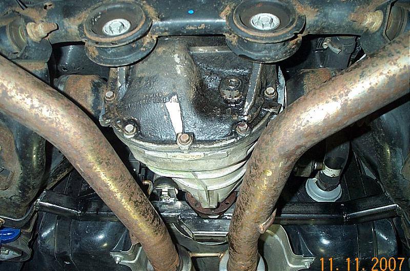

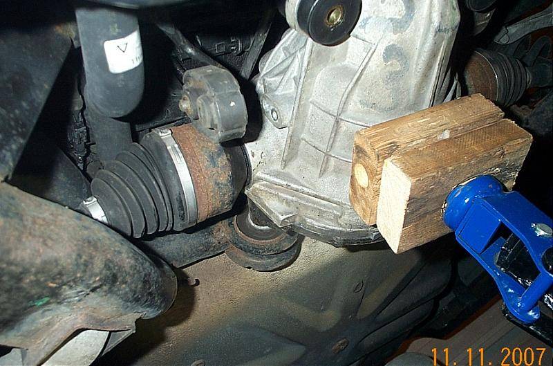

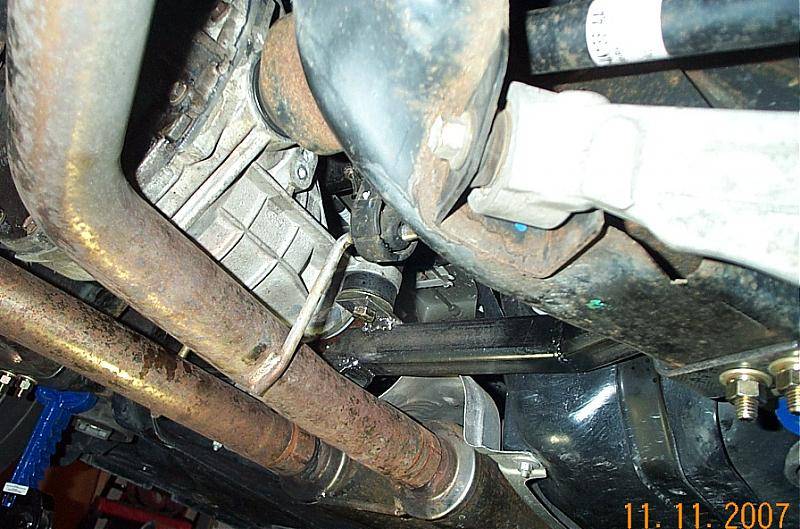

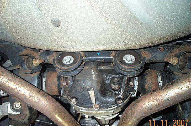

Here's a few.

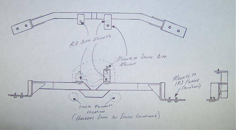

My original brace design that I drew up several months back ended up being pretty close to what did work well. I have to still tweak the exhaust a little to the right, it always hung to far left, this is a good reason to correct it as its real close to the brace on the right side.
The diff cover was a extra I picked up and scraping the undercoating off wasn't a priority. Notice the 8.0...sneaky hey.
I'm going to pull the brace over the winter so Weld Master Rob can close up the open ends and its getting powder coated for the finished look.

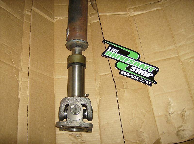

Okay I have a few questions.
What did you have done to the shaft, exactly.
Or would it just be easier to ask the shop to make another one like your's
How much did they charge to mod the shaft?
Did you do anything with the rubber quibo(sp) at the front end???
Posted by: 02LSE96LSC91SE84TC
Quote:
What you see in the pic is what was done. The rest of the shaft is stock so yes the rubber damper is still on the trans end. Cost me $60 to have it packed and shipped to them and the modification shipped back to me was $289.75 so $350.
To make a custom 2 piece would cost alot and not sure if worth it, If I was gonna shell out some coin I'd want the center bearing gone. A one piece would require a adapter at the trans end, likely a slide shaft there like the one pictured above to clear the shifter linkage(never measured to be sure) then a big shaft back. The gas tank limits diameter. There is maybe 3/4" between the stock rear shaft which is 2 1/4" diameter and the gas tank. Never measured exactly but I can just get my hand between there. That would mean a 3 1/2" would MAYBE fit but tight. Your not going to get by with a smaller diameter and 4" may be needed with the taller gears. The one piece shaft would be in the neighborhood of 61". A person could POSSIBLY shim the IRS(not the diff the entire IRS) in the car for more clearance. I stuck with this way for now but do toy with the idea of a one piece. It would be nice to loose the other rubber coupler and ditch the center bearing. It bounces alot on high RPM hard shifts in SST, at least it feels like it, I backed my shift pressure down cause of it awhile back while still on stock gearing.

SO there is a cross member that has to be modified to do this 8.8 4:10 swap... i read this hole thread and its still not clean to me...
I saw the pics but cant tell what was changed... if a cross brace is need can you guys fab them up and produce them to the public.... I will try this on my gen 2..
Posted by: ILLS
I could fab another crossmember up for ya if you need. It will not be free of course. I still need to weld Jason's crossmember up on the end so that the ends of the tube cannot allow corrosion inside. Maybe whenever I do that I can remember to take a measurement or two of the brace I made. The night I made his it was just too damn late and I was too tired to sit there and record angles and distances for future use.

give me a price... the only other thing that needs to be changed to make it work is the drive line correct?
Posted by: ILLS
Quote:
For your Gen 2 to get a 8.8" LSD with 4.10's it will need to have Gen1 axles, Mark VIII center section with all guts, Modified driveshaft, and of course the brace itself.
I will send you a PM on what I would charge to make something like that for you.
