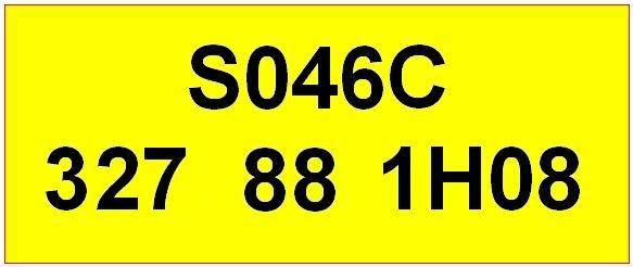

I need some axle info that I have not been able to find any place on the net. I am trying to decode the axle tag information.
S441A
3L27 880M20
I know that 3L27 is 3:27 limited slip
and the 88 is for 8.8
I need to know what S441A is for and 0M20 is.
Any help would be apreciated

No idea on S441A - Only FLM knows or cares. Probably the entire axle assembly with ends.
0M02
0 = 1980/90/2000
M = December
02 Day 2
A-JAN
B-FEB
C-MAR
D-APR
E-MAY
F-JUN
G-JUL
H-AUG
J-SEP
K-OCT
L-NOV
M-DEC
I not used to avoid confusion with numeral 1.
Don't know what year axle your looking at but it was manufactured on
2 Dec 1980, 1990 or 2000.
I hope that is close to the DOM for your car.
The tag on my 92 LTC is shown below
August 8, 1991
DOM of my LTC August 1991 from data plate on door.
Tim
