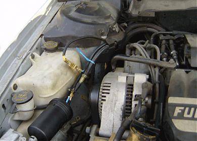

Tried the inexpensive airbag fix that was sent to me. As you can see from the car, the hind end is still on the ground.
As a side note, what you said, was inside the trunk area. But the lines, I cut are in the engine area. Filled with air but nothing happened. See pictures below.
Now what? I used the air at a gas station, so, plenty of air was going inside.

you need to tell the computer to open the solenoids someplace. if you have an error light on the dash, the computer has given up on opening the solenoids, and will not let air into the struts. and each rear strut has its own air line from the dryer, and each has its own solenoid.
installation of a schrader valve is common on these cars, but most people put it in the dryer assy.
Note: it will take 80 psi or more to raise the rear to ride height, these are NOT air shocks, but full air STRUTS, where the air bladder completely replaces the coil springs found on other cars.
the fronts will take 100 psi or more to raise to ride height.
