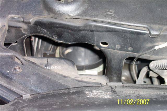

did you leave the plastic two hole vac on the pcv just cut it off it is universal for the air box you might have to pull out your inner wheel well on mine i dremeled out the front of the box and let it pull air from the bottm and top you will see a big hole in your core support you can enlarge it but it is not worth it or do some front ram air duct work with tubbing only thing cool about this is you pull open your plastic headlight cover and you can see if your filter is dirty

I felt the same way that is why i cut the front of the filter box open to pull air from behind the headlight i did this a year ago and could not be happier and the air flow sounds so clean so i think it pulls from bottom and top now
Posted by: papa bear
here is a pic
