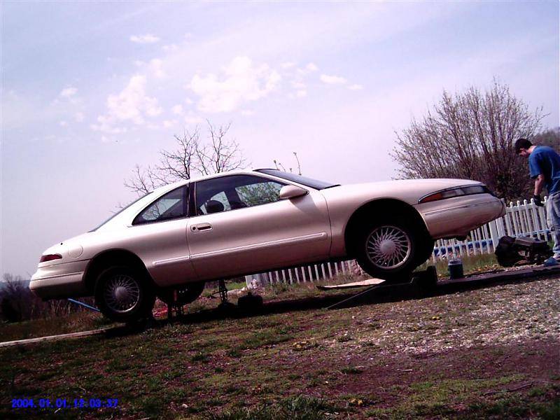

Posted by: Moes8
did this 2 years ago(2002 gt trans w/60k on it)
2 small floor jacks,2 factory trunk jacks and jack stands,basic hand tools,some cardboard to lay on stone/grass driveway,only me,no help what so ever,just the desire to drive my car again after losing the one way clutch.
spent about 25 hrs across 5 days
