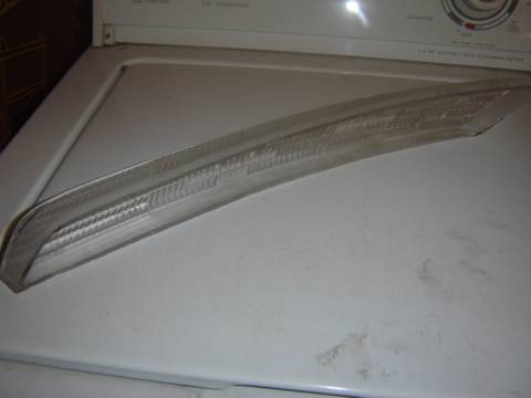

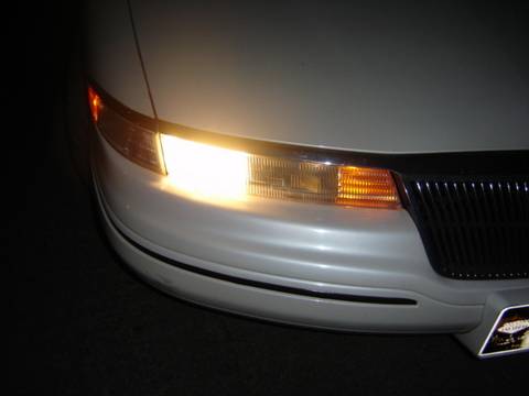

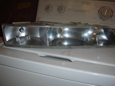

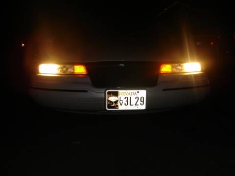

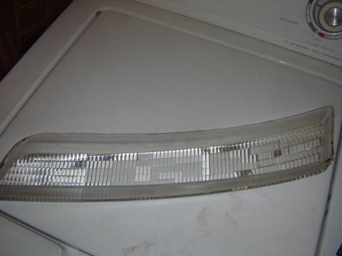

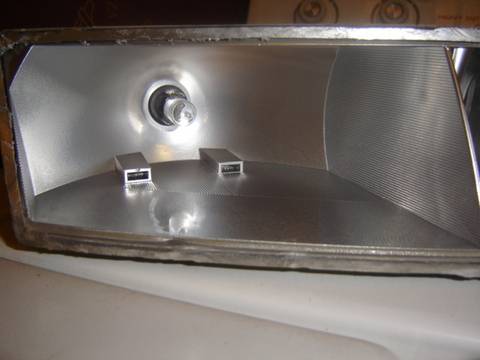

My headlights are 1 1/2 years old and still like new, My buddies 94 headlight housings were getting pretty bad. The outside was was just fine, it was the dreaded inside. The inside of the lenses were getting the brownish tint as they all do and the chrome was all burnt up. I told him that I could fix them or at least make them better and that's what I did. I took my dremel and with a cut off disc I cut the lense off just in front of where it's bonded on at, Very simple to do, I then cleaned the inside of the lenses with rubbing alcohol untill the brownish film was gone, Yes it does come off, I then took those black metal things that block the light bulb out and put them in the trash can! Now what to do with the chrome reflective stuff??? I very lightly sprayed a chrome type finish paint only where the chrome was burnt off at, I did several very light coats and it turned out pretty good. Not chrome like it was origionally but it did have a shine to it. I then placed the lenses back onto the housings and took my butane soldering torch and melted both sides of the plastic together in about 15 spots and then covered the entire line where I cut with clear RTV sealant.
Yes I know... A bunch of you will tell me that the black diffuser thingy makes no difference, Well if that's what you think then you are wrong! It made a world of difference and it does not blind cars or produce incorrect light patterns. I expected an improvement but I was really surprized at how well this little project turned out! The street is bright now and My buddy can see the road quite well! He is very happy with the outcome. Didn't cost anything but a few hours of tinkering around in the garage. I have included some pics of the results!

One thing I did notice when taking the lights apart is that nothing in front of the diffuser was burnt, it was all behind it as if the heat was being reflected off it and burning the chrome material. If I could somehow get them outta my new ones without cutting them I would!
