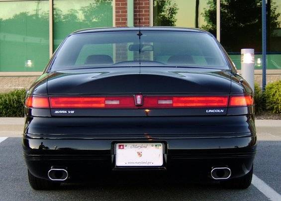

Posted by: dRock95MarkVIII
Quote:
Originally Posted by Markviiiedrea View Post
On a side note, that is one sexy ass, where did you get those tips?
Thanks! They are Magnaflow 35175 tips which I painted the centers hi-heat matte black. I ordered them through Summit.
I installed the same tips on my other car as well;
(click)
Though, the Mark looks a bit cooler with them
