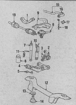

Posted by: Frat-man-du
Here is an explosion of the rear suspension
Posted by: DysfunktinaL
It looks like number 2. From the top of number 2, it connects to the controll arm with a nut/bushing that requires what looks like a star wrench to remove, correct?
God, please tell me that is not the knuckle.
http://www.trademotion.com/partlocat... ayCatalogid=0
Okay, so.... I was able to locate a used Knuckle for $125, but I was told I can haggle them down lower if I want to. Just an FYI for all you guys out there needing parts for your fords, and you are on a budget, check out www.all-ford.com
