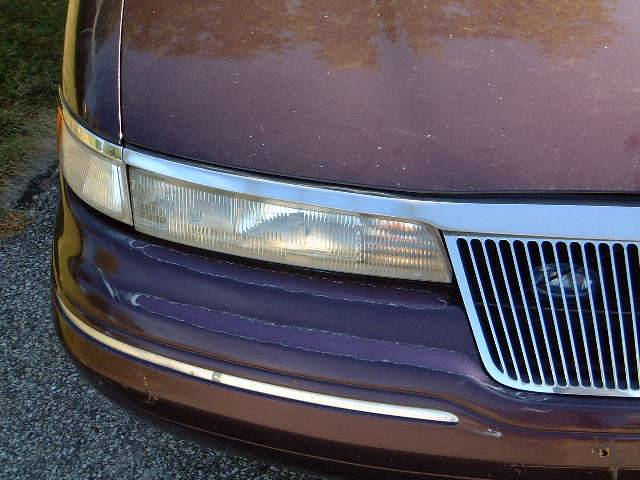

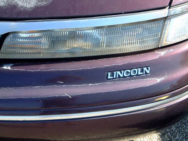

Look what @ 20 minutes can get ya (Gen I)
Posted by: 1wykdmk8
Like the caption says, I spent @ 20 minutes each side, and then gave them 2 VERY heavy coats of wax. Hope they will stay this way for a while.....tired of not seeing at night, and I even have 85W fog/driving lights behind the grille.
I used (basically because I have it handy) some rubbing compound, then I used a cleaner/glaze putty (again because I have it handy), then some hand glaze, and then several coats of a cleaner wax. Then I place 2 VERY heavy coats of wax on the lenses to get them as clean as I can. I used a heavy hand, and rubbed vigorously to get these results. I can finally sorta see at night now.......
Yeah, yeah, I know......I have a slight paint issue.....I am working on other things at this moment, so the paint is not a big deal to me.

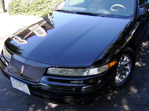

Posted by: dRock95MarkVIII
I wet sanded mine up through the grits, polished with Mirror Glaze #44, then a final polish with PlastiX
The divided lens still bugs me, though. Someone please hook me up with some 95.5-96 LSC housings!!!!
Posted by: rickztahone
dRock95MarkVIII your car looks real nice
