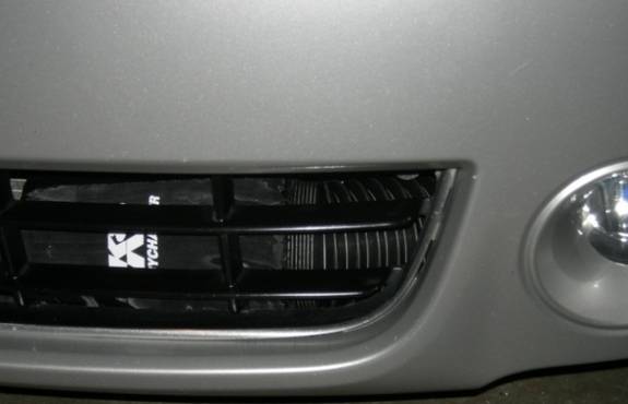

i wrapped mine in heat insulator wrap and dropped the intake tube behind my fog light. It stays cool even on a 100 degree day.
Attachment 29185
Attachment 29184
Posted by: loud00ls
i also remove the fog light for a ram air type of effect at the track.
