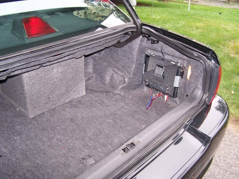

Thanks for the help guys. I did the install today and followed chickenviii's advice and ran the remote lead to a switch. After reading all the past posts on this I found hooking up the LOC to the rear speakers to be easier and save alot of time, rather than behind the head unit. All in all aside from the amp and sub the whole install cost me maybee $15 for the switch and LOC and took like an hour to complete. So i once again have the bumps in the trunk and with the remote wire on a switch I can turn the bumps off when the wife is in the car.

I ran a 3 lead wire from the switch and just put it into the same +12 and ground terminals on the amp. The remote input is in the middle of the two so for neatest look i figured that was the way to go. For what it is I have no complaints. I didnt really know what to expect as far as how it was going to sound but there definalty is that extra bump. Thanks again for your help.

Not bad, but PLEASE, make a couple small slits and run the wiring under the carpet. It will look SO much better and be safer for the wiring.
You did good makeing the wiring neat, now you just need to make it disappear.

what gage speaker wire is that? it looks really small
Posted by: poacheggs413
It's 16 gage, but its plenum rated to meet builiding code. I work for a high end audio visual firm, I had it laying arround from an old install.

It's more than enough since that amp only makes about 400 watts RMS at best, and depending on how its actually loaded down. It just doesn't have 3/32" of insulation around it to make it look huge while still only being 16ga.
Frankly, anything more than 14ga is overkill with less than 1000 watts RMS real power.
