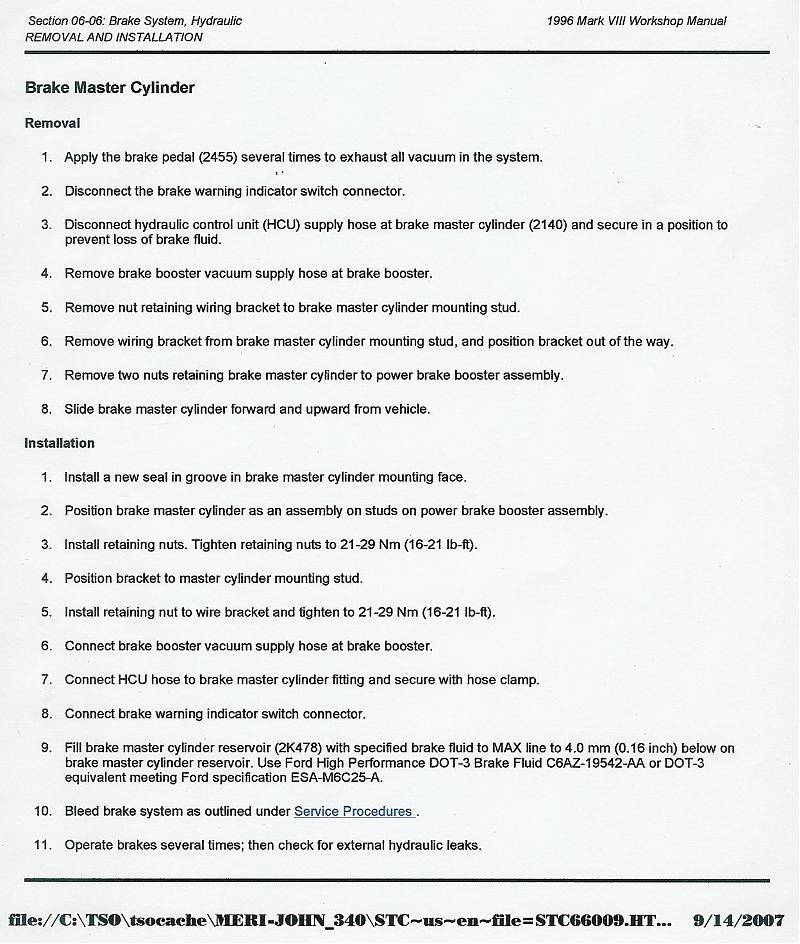

yes it needs a gasket....I have a dealers shop manual!!

Posted by: 93' Blue on blue
Thanks merijon! All done just doing the bleeding. Getting a new seal wasnt easy so i made one from a piece of rubber from home depot! Lol.
