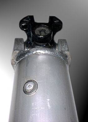

Heres the only weight on my Denny's shaft. See Denny's has one of only 3 balancers of the type they use in the World. It goes to 10,000 rpm's. Better balancing, less weight to balance makes a more true shaft.
