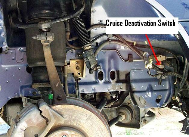

Just wanted to post a couple of pics of the cruise control recall switch, just so you guys can see where it is.
Posted by: turborich
How cool is that! Thanks for the pics! Looks just like the A/C low pressure switch. I am guessing that they wont have to break the brake lines open, just put a new switch on with a fuse???

That first picture look like my car

If you have a 93, it wont be where the pics show, FYI.

Posted by: mespock
Quote:
Where is it on the 93 if it's not there? As I have a 93, 94, and a 95.
Posted by: stone17
Quote:
On the 93 I think the switch is by the brake booster.
Posted by: driller
Quote:
Right. On the drivers side fire wall, down below the brake booster. PITA for access.
Posted by: stone17
Quote:
Here it is.
Posted by: mespock
Damn that thing is tucked away... You can see it looking up from the bottom of the car. I'm leaving this one for the shop... seeing that it's free.
