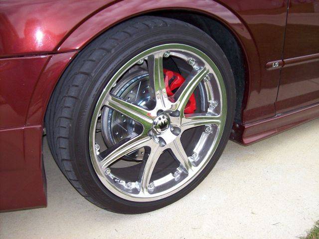

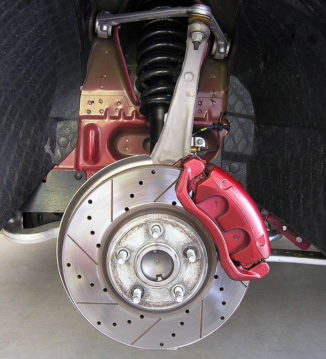

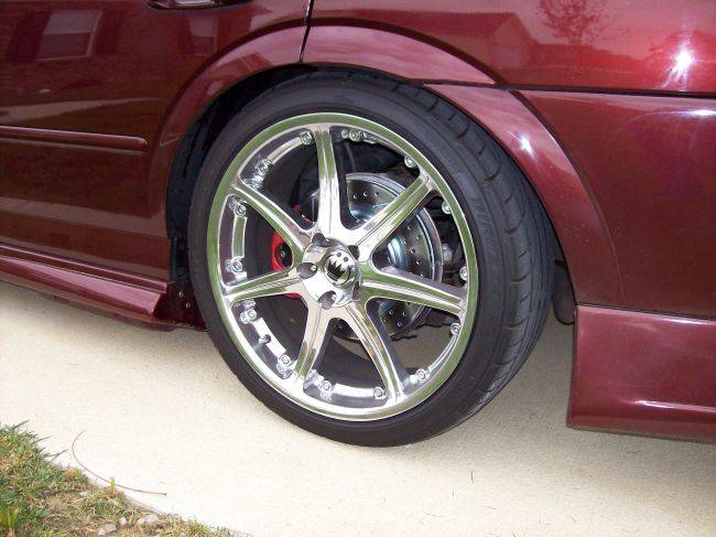

You can go the route I went.
Drilled and slotted rotors for looks (studies show that D/S rotors do not preform any better than stock rotors on a street car), high quality ceramic pads (I use Porterfield RS4's), painted calipers (mine are the same Vivid Red as the body paint) and stainless steel lines (for better brake pedal feel).
Picture shows my setup, minus the SS lines.

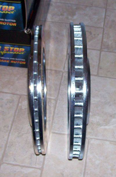

Power Stop Extreme Performance Drilled/slotted rotors with ceramic pads. I have them. Stop in a dime and leave change. Direct OEM replacement. I absolutely love mine.
