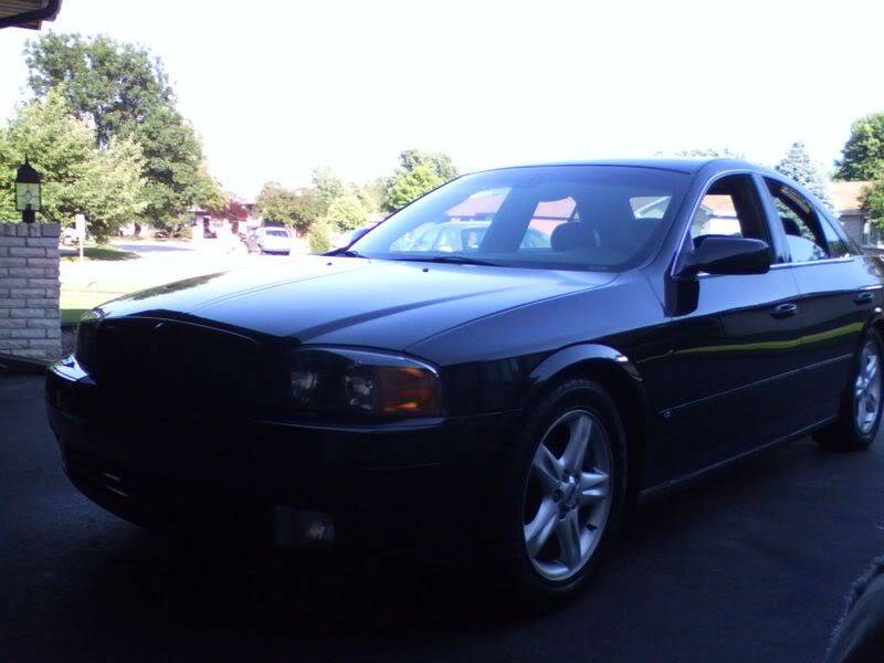

I just did the Eibachs today, I have to say out of all the springs on all the different cars I have owned these are the best. I honestly think the ride quality is a little better than it was stock. Here are a few pics after the install.

Looks great.

Car looks great. Did you replace the shocks when you did the springs? If so which did you use?

That ride height looks perfect. I want that set up.....
