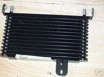

I got the 40,000 on ebay for 133.00 shipped has the bypass in it.
Posted by: ground_zero298
Like this?
