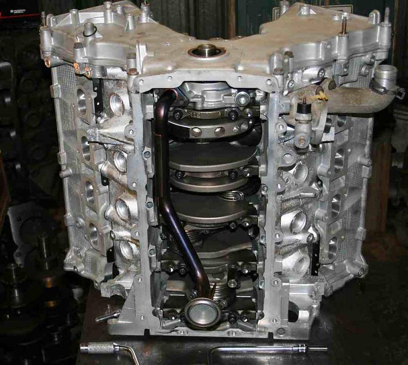

Take a '98 Lincoln 4.6 Alloy cyl. block: which I'm guesstimating is 'THE BEST CHOICE' - > Is this a 6 bolt main?
Anyone with some great .jpgs of a 'nakid' block 'n mains for the 4.6 and Navi 5.4 ?
It's a 6 Bolt main. See pic below.
Quote:
4.6 is pictured below
